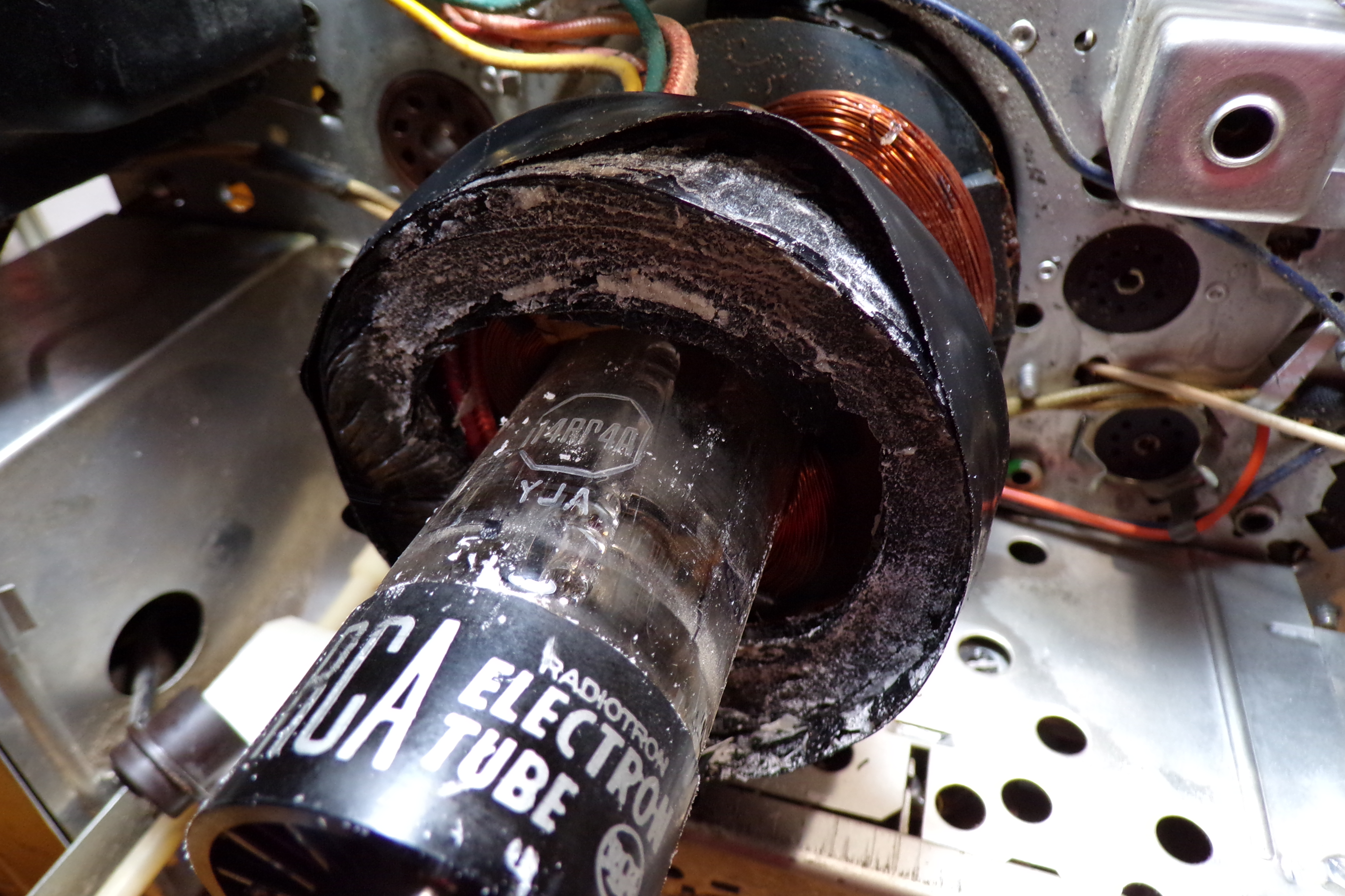

I know you guys like pictures.
The yoke cover fell apart when I got the yoke loose.. I need to invent something so I can use the centering rings... All you need to build a TV set.... Parts......

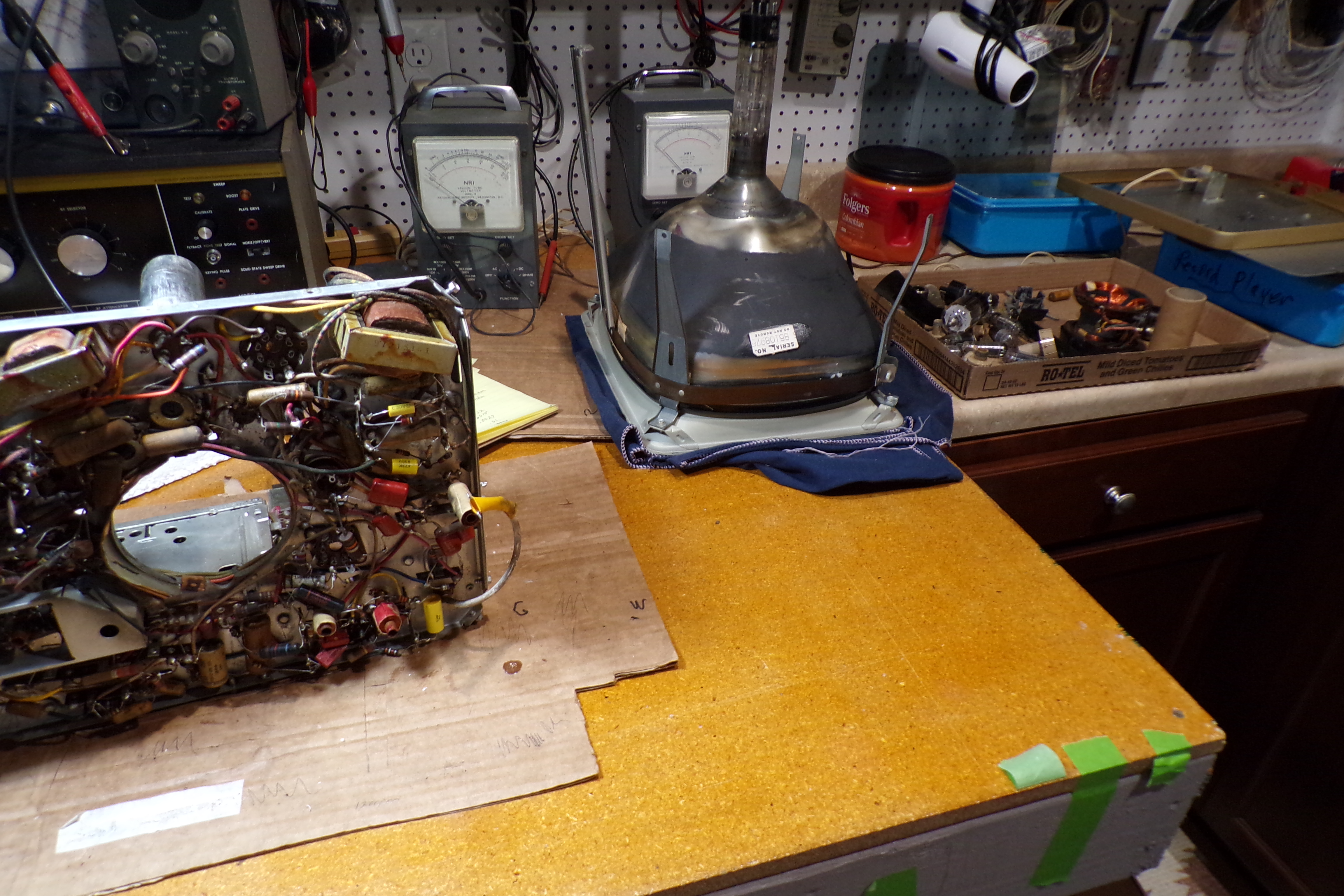

I am done with the recap project pending sourcing and procurement of parts. I have checked all the resistors. Most are within ten percent of spec. Many are within 5%. Only one was out of spec. Now I'm cleaning controls. The vertical height control acts wonky. I am suspecting tin whiskers, but I'm not sure how to troubleshoot the condition. Resistance readings on this control are all over the place, doesn't give the same readings twice in a row. I have tried cleaning the control with no luck so far. When I had the set running, this control made no difference. I think I have a plan for the yoke cover. I hope Harbor Freight has an inexpensive hole saw kit. I need a 1 1/2" hole saw, and I don't want to give a fortune for one just to cut thru plastic. I won't need a whiz-bang saw for that. After I get the controls all sorted, I need to clean the tuner. I have been advised to use caution cleaning this tuner.

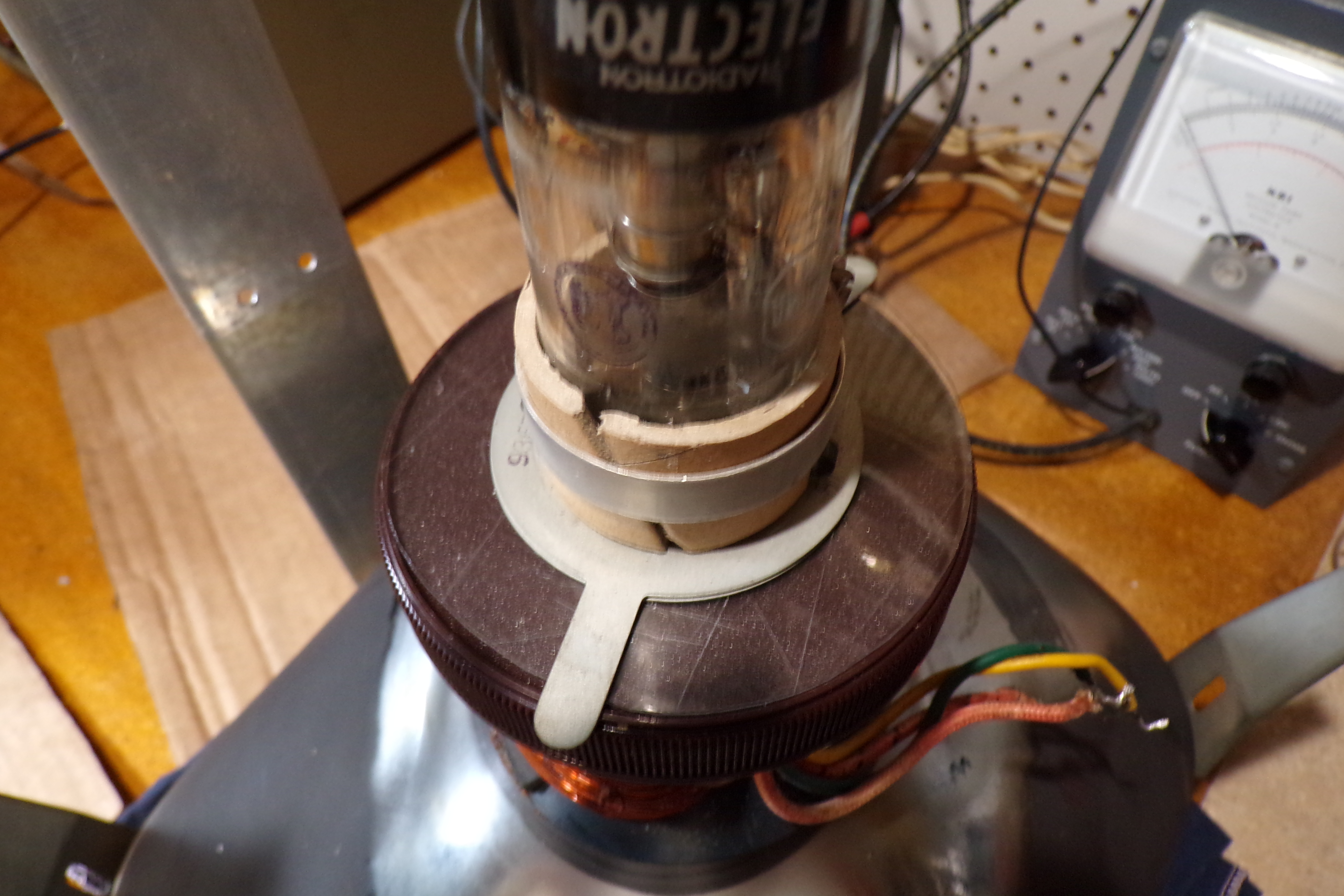

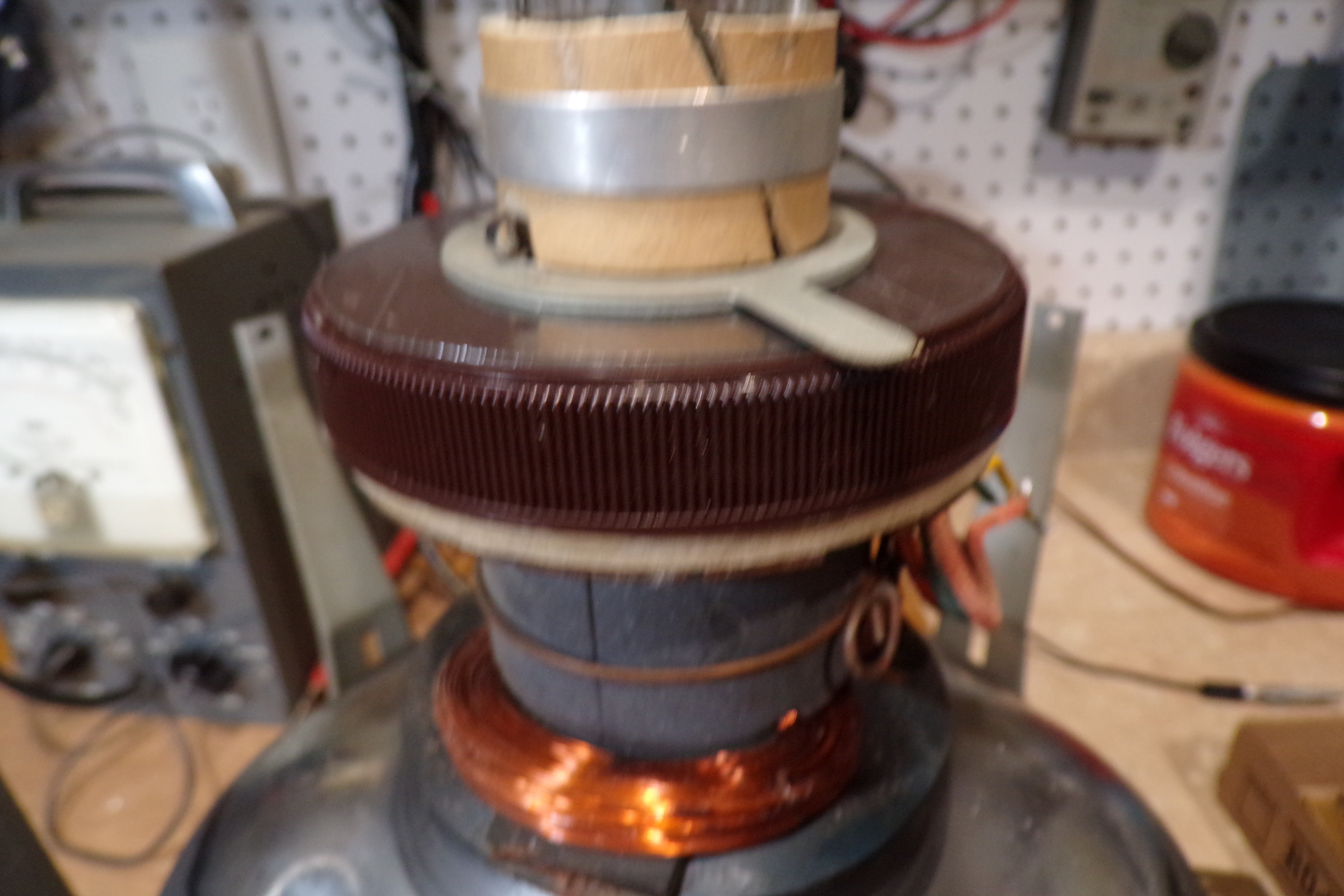

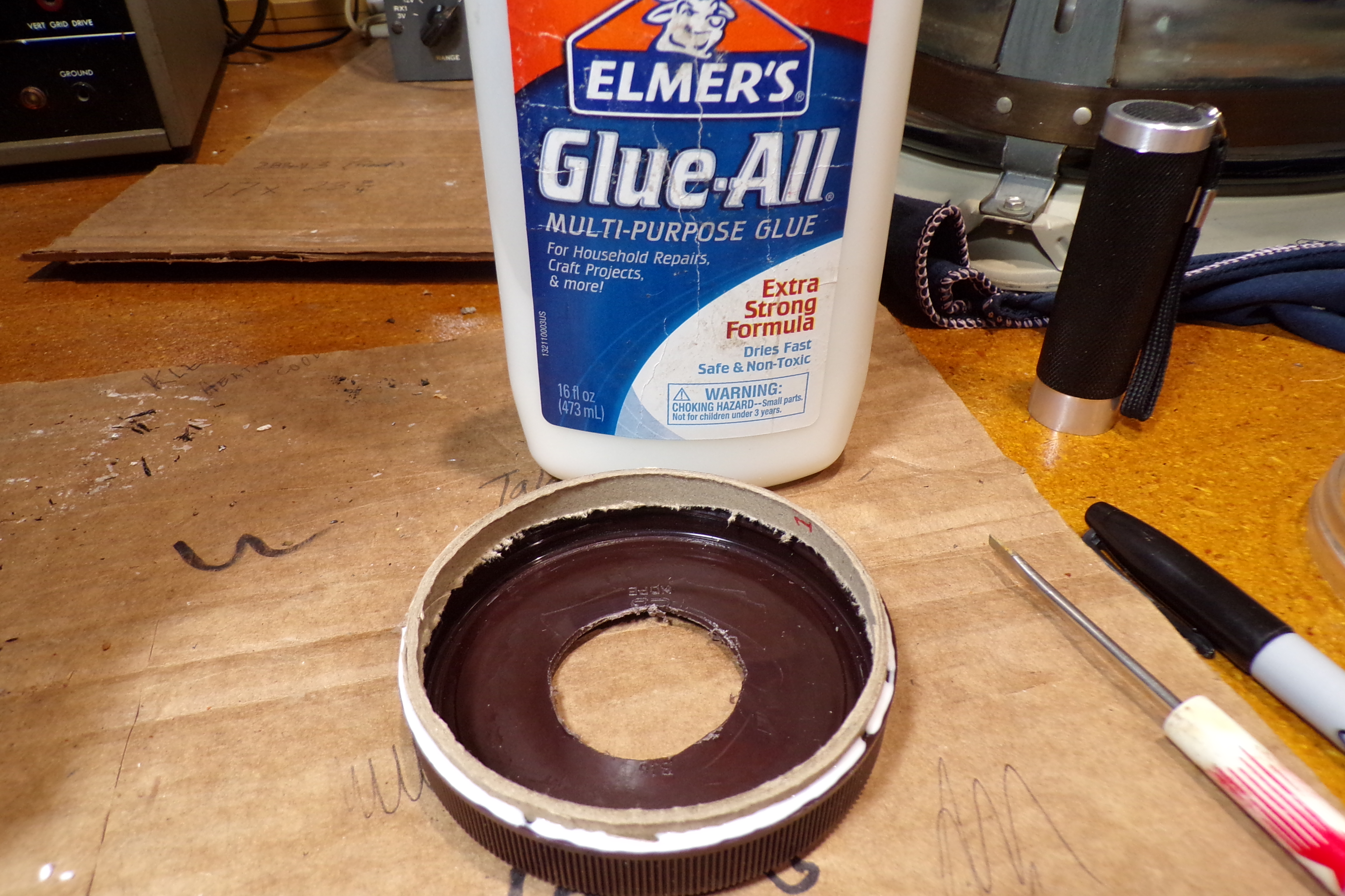

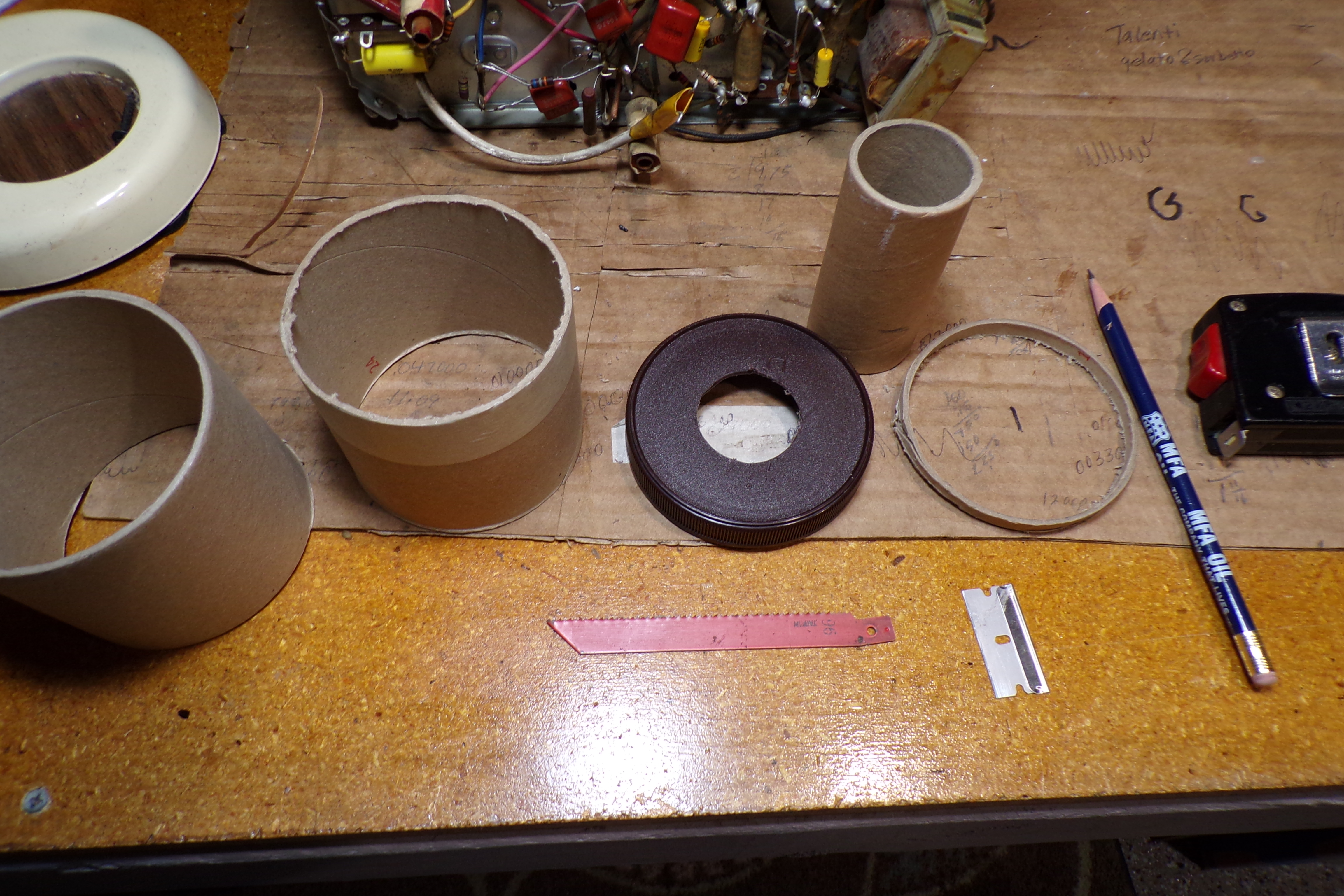

Pending my sourcing a power transformer, I thought I'd work on creating a cover for the yoke. I really thought this would be fairly simple. The TV guys were right again. It's not. Crist Rigotti made one out of wood, which looks really nice and works really well. I don't have access to woodworking tools anymore. That ship has sailed. I need to kluge up something out of junk on hand, literally junk on hand. I have the plastic lid from an ice cream container, a cardboard roll out of industrial-strength toilet paper, and a plastic lid off a cottage cheese container. This will be my starting point. The plan is to use the ice cream container lid and a chunk off the toilet paper roll to create the cover itself. Put a 1 1/2" hole in the ice cream lid, then glue a 1/2" width of the cardboard roll to the lid. The centering rings have two clips that hold them into place. I don't want these clips to come in contact with high voltage in the yoke, so the plan is to mount them on the cottage cheese container lid and put that behind the cover. I have a smaller cardboard sleeve, one I use to make Katie Caps, that I'll cut a length off of, cut a slot in it, then use it under the clamp to hold the yoke up on the picture tube bell. We'll see how well this works......
- Posts: 9020
Re: 1957 RCA 14" model 14-S-7070 TV set
I didn't want to spend $40 or more to drill two 1 1/2" holes. I got to looking around in my big tool box and found a 1 1/2 " paddle bit I used when I was running electrical wiring thru studs. The proper, safe way to drill two 1 1/2" holes in plastic would have been to use a round hole saw, chucked up in a drill press, with the work piece clamped to the table, drilling into a scrap block of 2x4. I didn't have that equipment, so I used the most dangerous, most likely to cause serious injury method I could think of. I used the paddle bit in a 3/8" reversible electric, not battery, drill. I found that if I ran the drill forward, the bit dug into the plastic, not only making a weird-shaped hole, but it would tear my arm off or run that paddle bit into the palm of my hand should it slip. I found that if I ran the drill in reverse, the wings on the edge of the bit that starts the hole would score the plastic, then I could just punch the center out. The 1 1/2 inch hole was just a fuzz too small to allow the piece to pass over the bakelite socket on the end of the picture tube. I used a pocket knife, a really sharp one, to hog out the hole just slightly so it would slide over the bakelite socket.

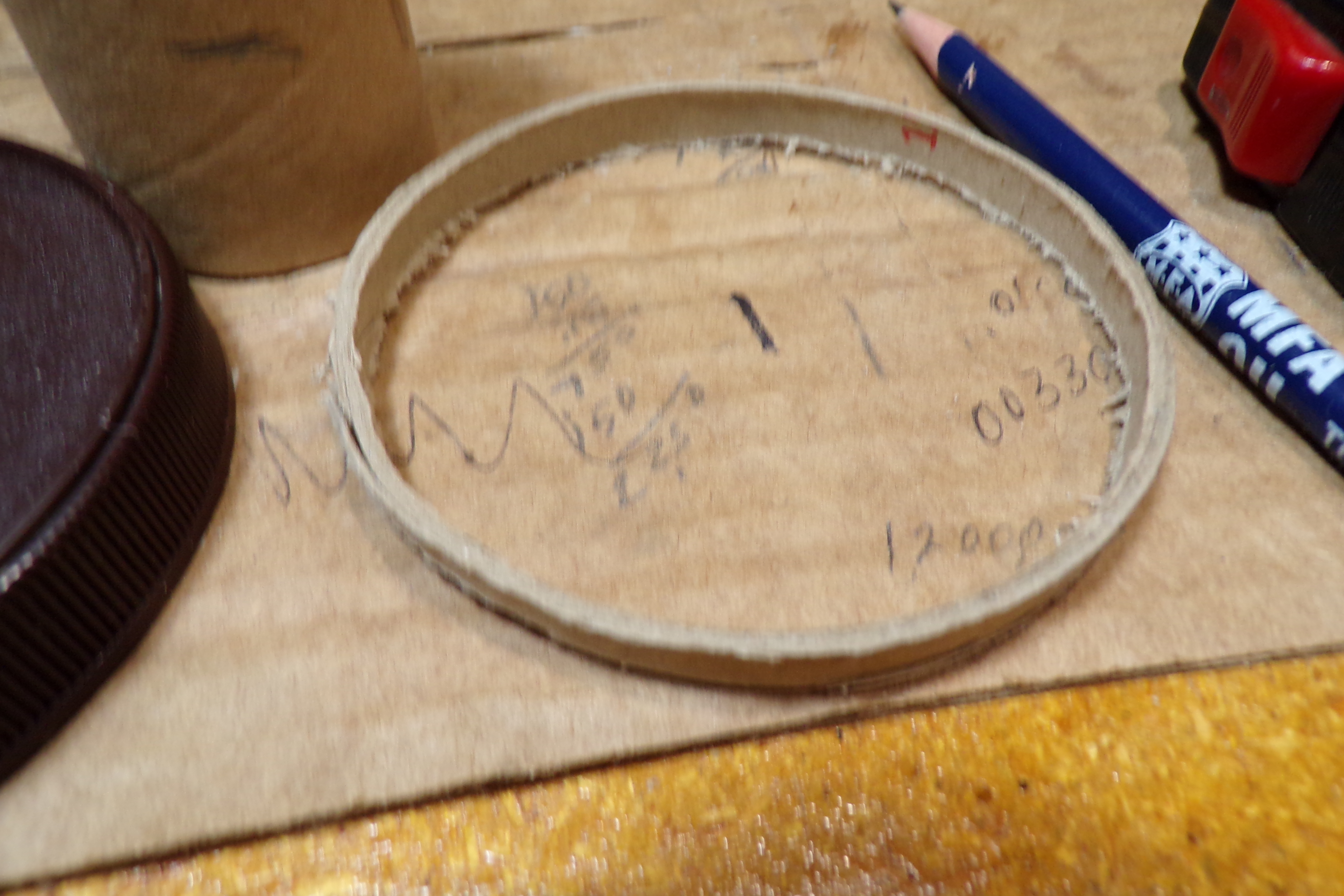

I judged that the plastic ice cream container lid I am using for a yoke cover might be a fuzz too thin so as to not impact the capacitors and resistors on the end of the yoke. I decided to extent the lid about 1/4" to allow for a bit more room without moving it out so far it would interfere with the action of the centering rings. I used one of the 3.5" cardboard toilet paper rolls, drew marks at 1/4" at several spots around the tube, from the end, then used masking tape as a border for my cut. I started the cut with a hand-held jig saw blade, then continued the cut with a single edge razor blade. This to get a nice, straight cut. I then set this ring of cardboard I had just cut in to the first thread on the plastic ice cream container lid. Then I ran a bead of Elmer's construction glue around the edge.

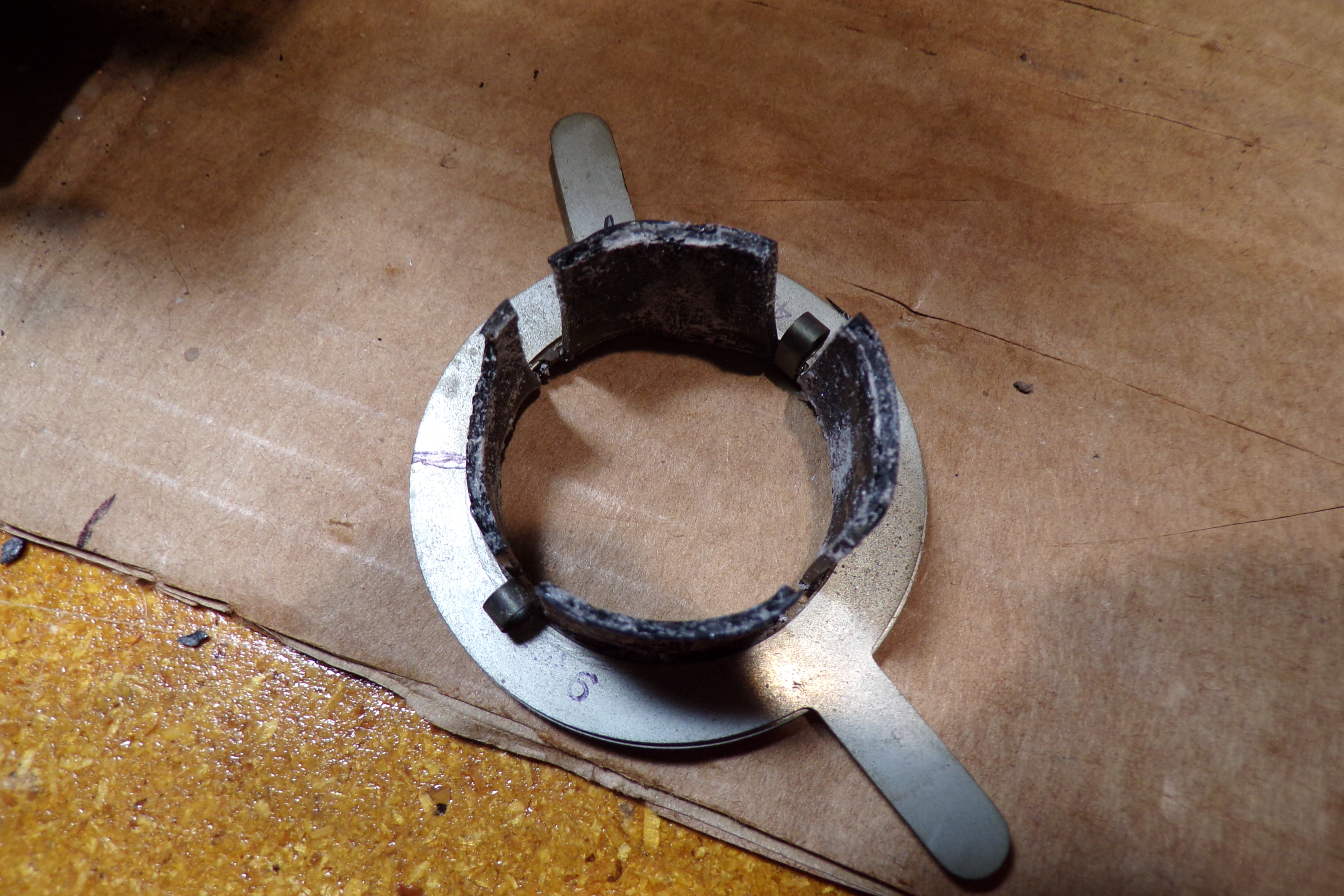

My next task was to kluge up a mounting for the centering rings. I determined that the cottage cheese container lid was too thin. I use plastic containers Swiffers come in and had a couple lids from these containers I had saved to make plastic dial covers from. I found these clear plastic lids were the correct thickness to accommodate the clips that hold the centering rings. I decided to use this extra plastic for the centering rings because I wasn't sure there wouldn't be any arcing between the high voltage in the yoke and the clips on the centering rings. I cut the 1 1/2" hole in the Swiffer lid, placed the cover on, then slid the Swiffer lid on. I drew around the cover with a magic marker. I removed the Swiffer lid with the markings on it, cut around the mark so the Swiffer lid would fit behind the cover. There may be some adjustments that need to be made during final assembly to this kluge, but I believe it is going to work.
The last part was creating a sleeve to hold the yoke against the bell of the picture tube. I cut a 1" piece from the end of a Katie Cap cardboard tube, but an angled slot with a pair of tin snips so it can be clamped around the neck of the picture tube. I had to find a longer screw for the clamp, but I believe this is gonna work just fine. I have pictures that I'll share once I get them loaded to my computer.
I made the yoke cover from scrap junk I hauled out of the trash at the store. The ice cream container lid was a fuzz too large. This cardboard ring did the trick. I glued the cardboard ring into the lid using Elmer's glue. This is the cardboard sleeve I made to hold the yoke in place. I hope this will work.

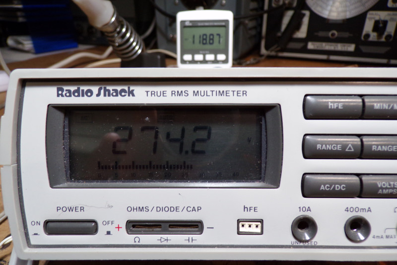

Pictures to document the power supply mods
Measuring AC across the rectifier plates.
Line voltage AC shown on Kill-A-Watt. AC plate voltage shown on digital meter. It pulls not quite 4 watts from the AC line.
