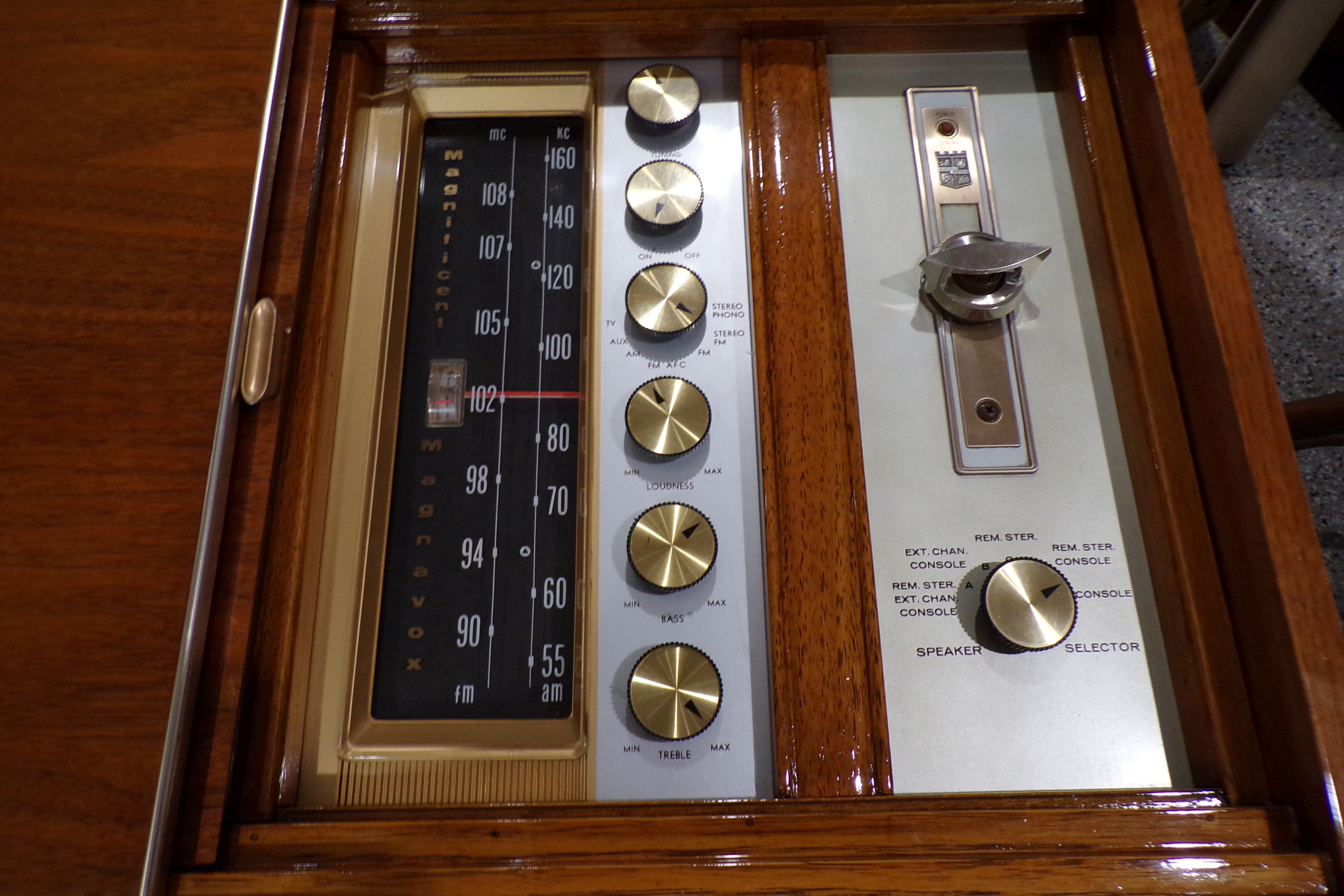

This particular instrument represents the top-of-the-line 400 series of Stereo Theater built by Magnavox. The 400 series had a 27" TV, standard Multiplex adapter with remote control optional. The 300 series Stereo Theater had a 24" TV with MPX and remote control optional. The 200 series Stereo Theater had a 23" TV with MPX optional and used the 100 series tuner. In any version a Magnavox Stereo Theater is an electronic work of art. Mine has the 93 series amp, 27" C36 series TV chassis, the 70-series three tube MPX and the 77 series "top secret" tuner. I say top secret because I never did find a diagram for it yet to this day. It has 12" side-firing woofers and front-firing horn tweeters. It also has the S-600 four speed Collaro record changer. This one has a total of 36 tubes. Plus, it has sonic remote control.

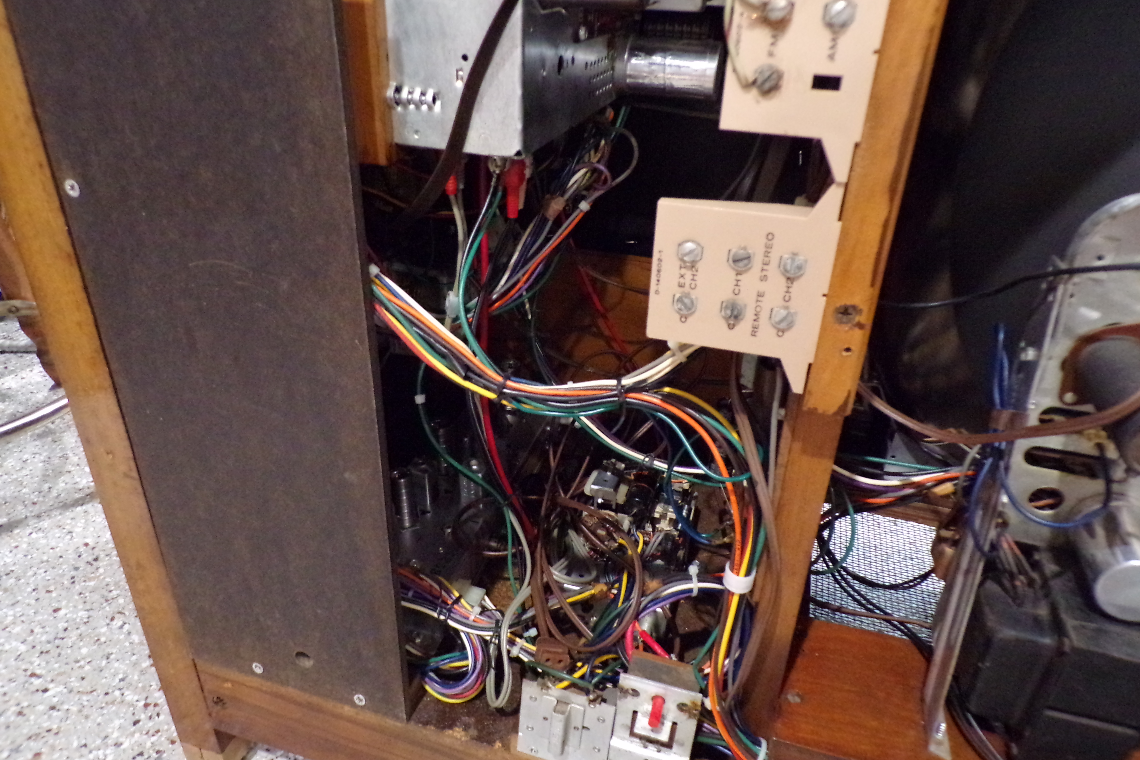

The electronics were completely rebuilt. Amp, tuner, MPX and TV chassis. The TV chassis is not finished, but I did have raster, but no sound or video. R43, the AGC resistor is open and will be my first task when I get back on this project. I have test sockets so I can inject a signal from the TV Analyzer to sort the rest of the chassis. At this point, I'm looking at something going on in the tuner or maybe one of those pesky diode thingies that always go wonky. This thing may actually give my Symphony a run for its money performance-wise. 12" speakers don't hurt it when it comes to bass response. I brought it up on the Variac and KAW. I was pulling 160 watts at 118 volts line voltage. I had a weak/dead Channel 1. I tinkered with the 6EU7's but they were not the culprit. A dirty balance control on the amp was the cause. This thing seriously kicks butt. It has one of the better Magnavox tube tuners I have. IT has AFC, so that is a definite plus. It will peg the tuning meter with only a length of lead in from the back of the cabinet to the tuner.

I'd say that AM performance is pretty good. The caveat to that would be the highly-directional loopstick antenna Magnavox used. FM performance is what stands out. I've never connected an external antenna, so it would probably be even better with a better antenna. I have never heard the audio from the TV to this point. It will be mono, but it should sound pretty good. I know some manufacturers of three-in-one consoles had separate speaker or speakers for the TV. Magnavox ran their TV audio thru the stereo system.

I have been tinkering with my stereos this afternoon. I have had four of them on at once. All four at once sounds pretty good, especially when one of them is the CG and one of them is the Stereo Theater. The Stereo Theater will outperform the CG in almost every catagory, particularly tuner performance. We have mentioned this before, but it is worth mentioning again. No doubt the tuner in the ST is hands down the best tuner I own in a Magnavox stereo. IT is rock steady, AM or FM. It will give 3/4 deflection of the tuning meter, only using the loopstick, tuned to the little flea power AM station I listen to. A 250 watt clear-channel station, 1340, "The Bull". You can hear it from Apache Junction clear down here, about 20 miles......
AFC certainly helped FM performance. This thing is a sweetheart. I am impressed more each time I listen to it. I am running it at 112 volts line voltage, powered by my iso/Variac contraption. It pulls 126 watts, amp, tuner, and MPX. I'd love to have it sitting next to the Symphony, connected to the same CD changer.
