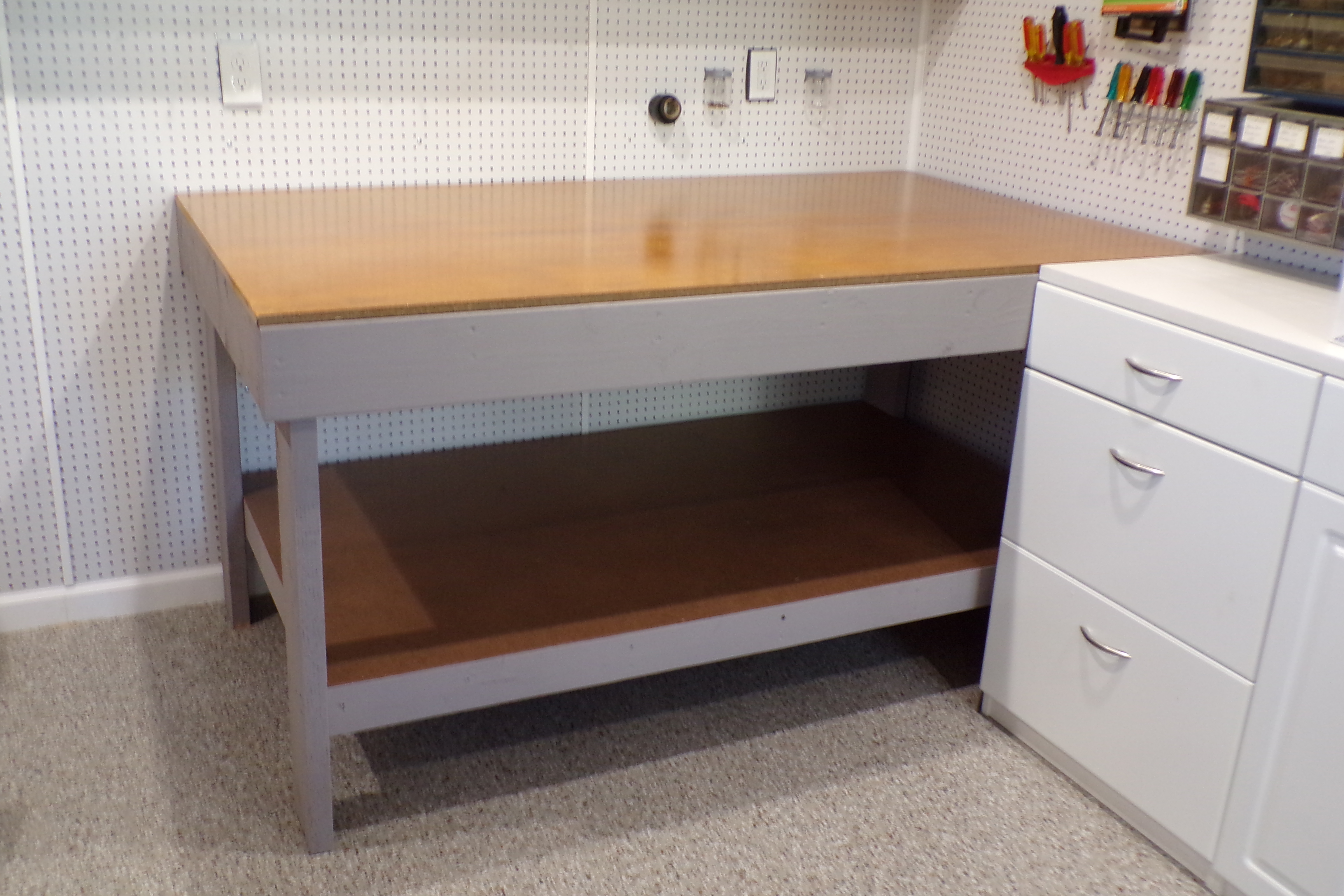

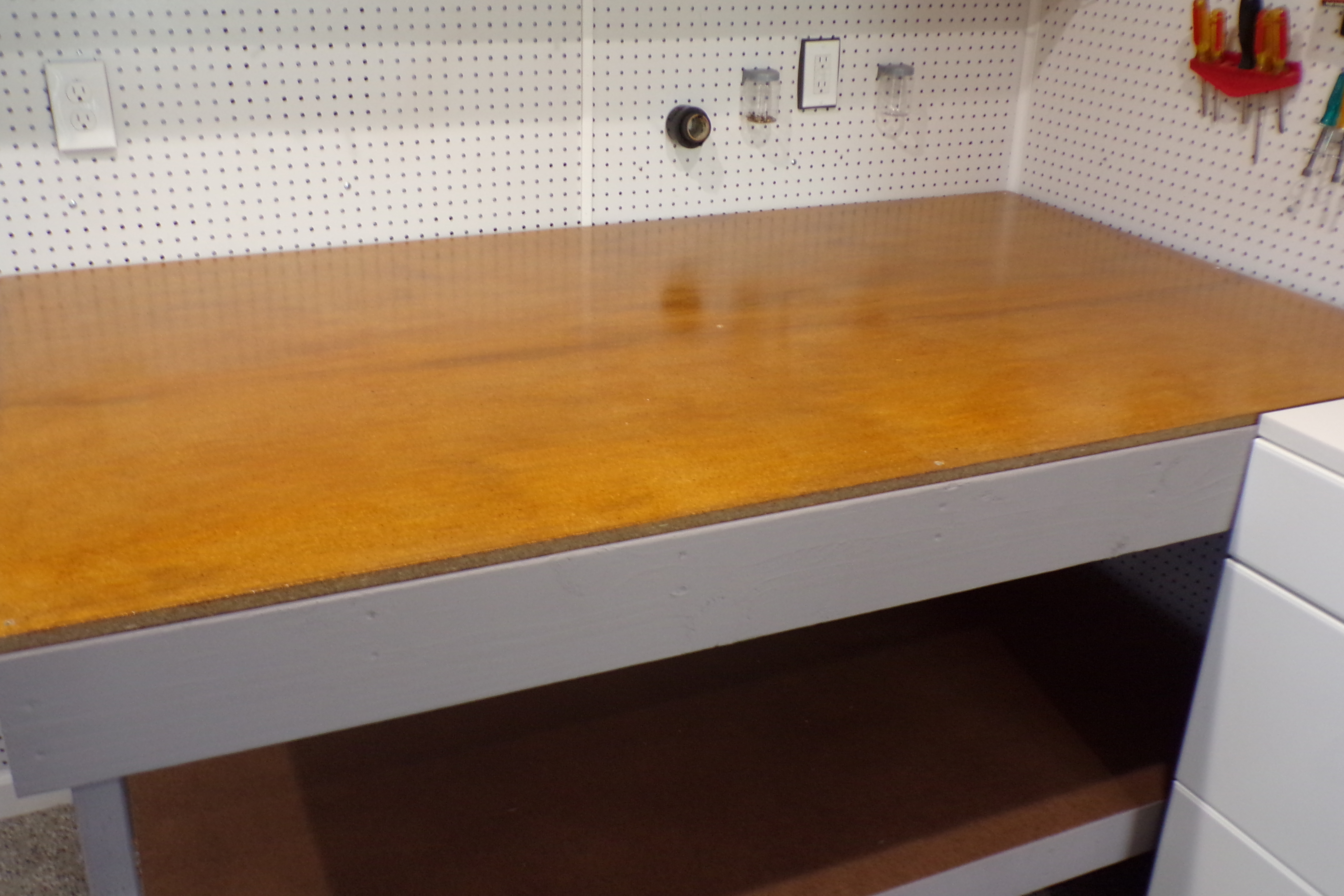

After all the handwringing about what type of bench I wanted, I settled on a home-built affair. I built two 4'X8' tables in Missouri from scrap material. I built them with a 2x6 frame with 2X4's set 12" on center and no lower shelf. They were sturdy and oh, so handy. Strong enough to hold an engine or maybe even the whole car! So, taking that cue, this bench is 42"X72". Why not 48" wide to utilize a full sheet of material? you ask. 48" wide would not work with my other cabinets. 42" worked perfectly and 72" long works with the cabinets on the other wall. I painted the frame with leftover paint from the shop trim, a medium-dark gray. The shelf is tempered Masonite, framed on 2X4's set 12" on center. The top is particle board framed with 2X6's with 2X4's set 12" on center for support. I used 2X6 legs this time instead of 4X4 to save money. My budget was $200 and my bill was $108.37 with tax, so the material was right around $100. I still need 24 more 3" deck screws to complete the job, and I believe Ace Hardware sells them by the each. There was a nice young man at Home Depot who helped me pull straight lumber, then cut it with military precision, right on the money, and every single piece fit like it was born there. I had no clamps and only a little tri-square to help with assembly, but Jacob's precision cuts made this no big deal. I still need to figure out a plan for a finish for the top working surface. I don't want bare particle board. My thought is, if I can find some, to put a couple heavy coats of shellac on, followed by some darker stain, then either spar varnish poly or maybe epoxy if it isn't too fumy. I am open to suggestions. I settled on particle board dependent on price. MDX was $55 a sheet, particle board was $12 a sheet. I figured for the difference, I could work the top so it would work. I would have to finish the MDX, too, so this will be a considerable savings. Jacob selected white lumber instead of doug fur and saved me a ton. The bottom shelf can hold test equipment and maybe my little GE stereos until I get them done and find them a permanent home in the shop. This bench is 36" tall instead of the 32" I built the ones in Missouri. Bob Andersen made a bench very similar to mine and made it 36". This height will allow me to utilize my little three-legged stools to advantage at the bench. The shop is a disaster right now, so, if there is interest, I'll take some pics to share when I get the mess cleaned up a bit.

The bench is in it's rightful place in the shop. Almost every other piece in the building had to be moved to allow it to get there. The height is nearly dead-on perfect with the other cabinets. It is square and stable. I am thrilled with this much progress. I have a huge mess to clean up, but that is part of the fun, right?

If ‘t’were me I’d forgo the stain + shellac &c and paint the bench top with 2 coats gray epoxy. I leave the frame unfinished since it doesn’t see any real wear/abuse, still looks fine since that 3’ x 8’ bench was built Dec 1974, bolted together to accommodate moving.

Yeah, epoxy would be better, perhaps. The problem with epoxy is that I can't handle the fumes, physically. I don't breathe like you guys do, so my natural filter of nasal passages aren't working. The label on the epoxy recommends using a NIOSH respirator. Anything with that recommendation, I have no business messing with. Shellac and water-borne polyurethane are sufficiently non-fumy that I can use them without danger. I still make sure I have cross-ventilation. I am satisfied with the results. The wife wanted me to use a commercially-built bench so it wouldn't look so, shall we say. "Rustic". I have always had bare wooden benches that got dirty and beat-up looking. She wanted something that looked nicer. So this one is a compromise. It is home built like I wanted, but is painted in colors to match the floor and with all the joints and screw heads caulked so you can't see them. Sometimes, we have to do the best we can, and compromise to keep peace in the family.

I brought a chunk of cardboard home from the store that I'm going to use if and when I am putting a chassis on the bench that might dig into it. And I can always resand and add a couple coats of shellac and polyurethane if I do dig into it. I don't want it pristine, necessarily, just better than I have done in the past.
