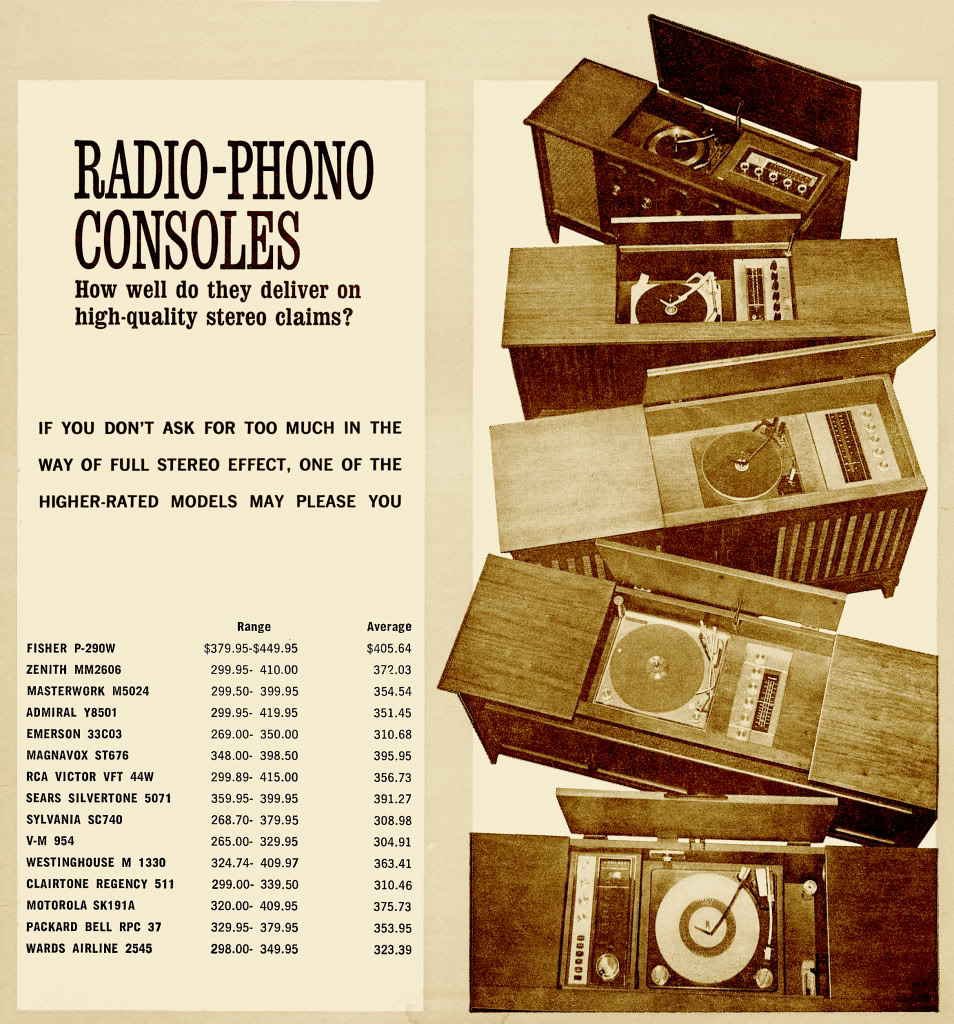

Here's CU ratings for mid-level consoles, I think about 1964. I believe some may have been tube models but some brands transitioned to SS earlier than others. The FIsher Philharmonic IV P-290W (walnut) still has a all-tube chassis, but others may have been SS or hybrid by now. It'd be interesting to know what years the major makers went to SS. Fisher varied model by model but tended to be a bit later than most. Oddly, unlike Scott, they used Germanium transistors at first. These are listed in ratings order from their test results. A mid-level model typically ran in the 350 to 400 range + or -.

The Zenith in that list is a 1965 model, possibly with just a solid state amp and tube tuner/preamp.
I know GE, Fisher, RCA, Packard Bell and Zenith had solid state designs for amplifiers first then transistor based preamp/tuners a year or two later. RCA made a decent enough germanium transistor, not good enough for some like HH Scott who went with silicon transistors.
Magnavox went total solid state before the others, starting with 1963 or 64 models. The RCA transistors they used in their consoles before even RCA did! Motorola went all SS later for some reason, most 1964 models I have seen are all tube. That always surprised me because Batwings were symbolic of solid state, making 2-way communications history
Admiral, Sylvania and Philco had solid state designs starting with 1965 models. Many TV-radio-phono combos were made by these three, but their TOTL electronics was found only in a big console. I have a 1966 Admiral combo whose SS receiver uses Texas Instruments silicon transistors.
Cannot speak for Sears and Airline but I would avoid those SS unless they used RCA or other reputable transistors.

Quite a mixed bag of tube and hybrid and SS electronics for those models then! Thanks for that info Dave!

Magnavox introduced their Astro-Sonic line of solid state instruments for the 1963 model year, along with holdover all tube models, often in similar cabinets. Magnavox never made a hybrid stereo console chassis.

Fisher made hybrid consoles with tuner-preamp tube chassis with SS amp outboard stages through about '67, possibly later even, a wise thing probably as their Nuvistor tube/all-tube front ends and preamps were truly exceptional performers.

So far I have looked up a few schematics on these consoles listed. Most are tubed and, in an emerging solid state market, these players were bargains at the time.
The Fisher P-290 is all tube with PP 6HU8 output tubes.
The V-M 954 uses SE 6BQ5 outputs, like earlier models.
The Motorola SK191 uses Germanium transistors for audio driver and outputs only, rest is tube and much of it on a Printed Circuit board.
