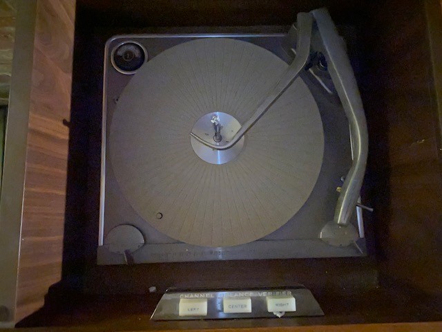

The most popular model series, the SK-77 Drexel walnut followed 1960's SK-32 and a similar 1961 model.
Always wanting the one with those awesomely back-lit knobs, channel balance verification switch and slide-rule dial, I missed two of these over the last 10 (!) years. This was an easy pickup on a dark night right after work. It fit right into the car and made it home where it sat in my car for a week, before I got a chance to carefully unload it.
The condition is ultra clean, sitting in storage with other furniture of the seller's Grandmother.
He did not recall where it was purchased but that she did like to play records.
While I can only guess what she played, I was pretty sure she had excellent taste in a record player.

I'd love to hear one of those. Handsome devil, too.
