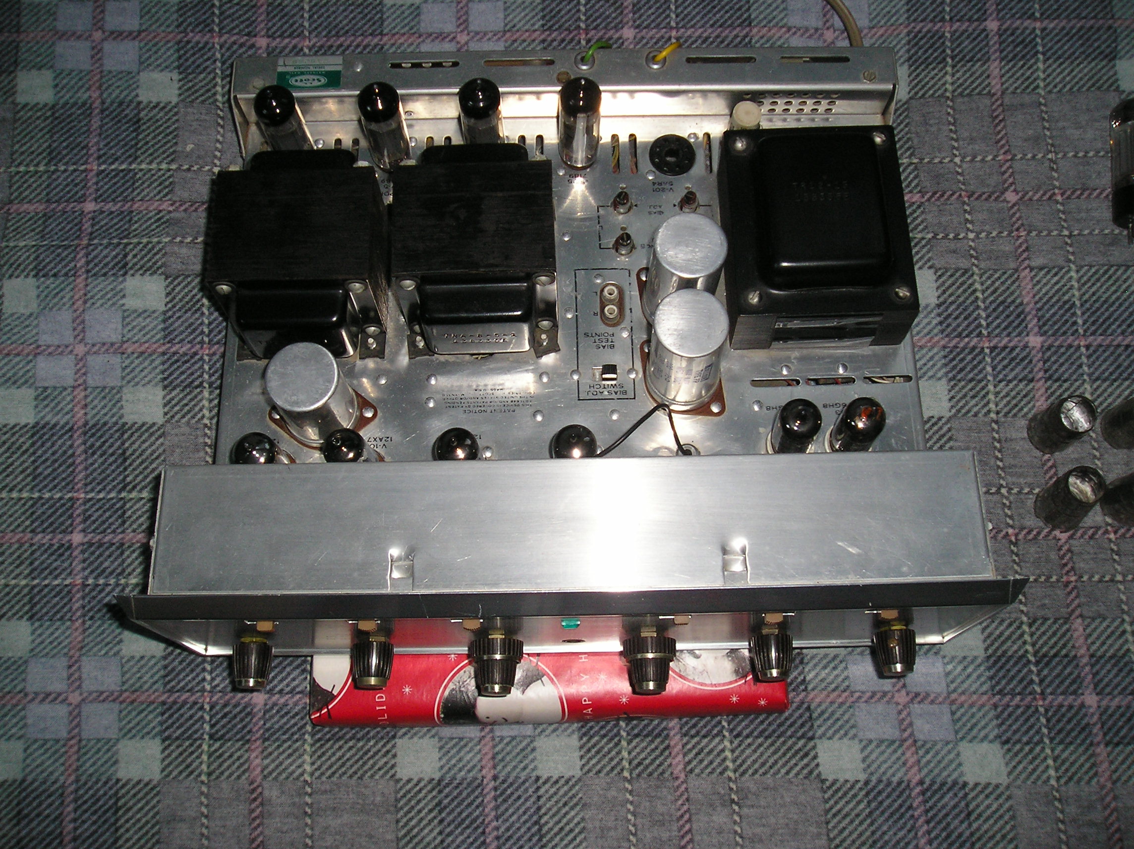

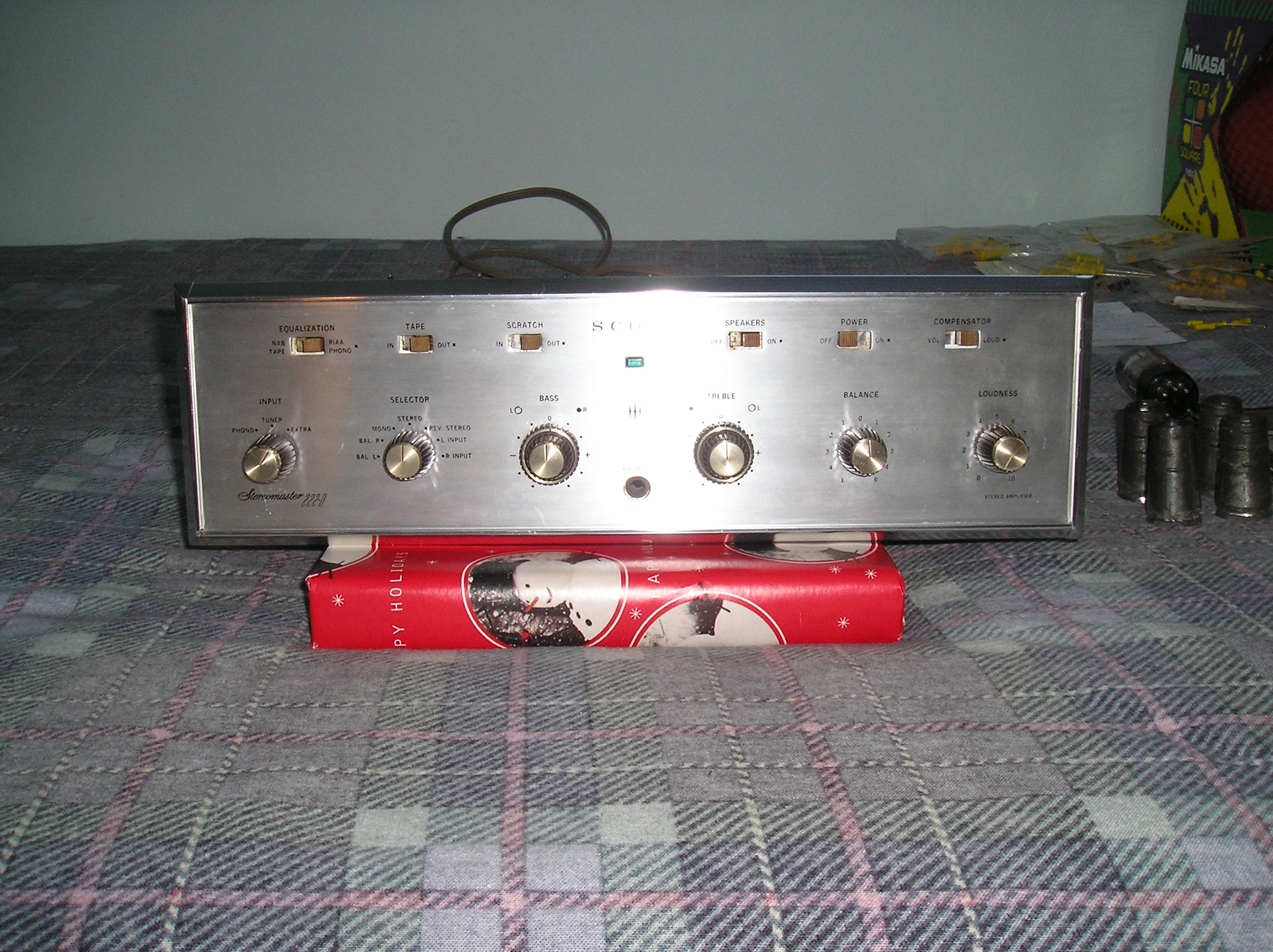

Scott may have used their 200, 222, and 299 series tube amps in pre-1966 consoles, all superb performers, among the best in their power class. I've only seen 1 or 2 Scott consoles that had console-dedicated receivers, usually just one of their component receivers turned to have a N-S axis. Here's a 222-D we have and will never willingly part with. Just look at those trannies...now that is a proper amplifier.

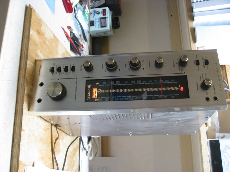

If you have special insights into the early SS receivers from Scott, please let me know. I've got a 382C that seems to eat MPX chips. It uses a 28V stereo and Perfectune bulb set and that seems to be a lot of power running through a chip. I put heat sins on some of the individual transistors that seemed to run hot.

The Scott is running pretty good, but the MPX portion of the FM is not up to par. It only goes into stereo on a couple of strong stations, not necessarily the strongest ones. When I picked this up the turntable was glued together with lubricant, you couldn't even push the start/stop lever to either side. I sill have an issue with it as it won't shut off when playing the last record. It's not any linkage, it's that there is something that has too much friction preventing the switch to complete. I did notice that I can feel a slight resistance on the start/stop lever. I had a Dual 1225 back in the 70's and I don't remember any drag on the lever. I'll get back to that later. The receiver is kind of a "combination" of sorts. It has parts from the 342, and 382 receivers. The chassis has been recapped, but FM didn't have any sensitivity at all. The meter was lucky to get just below center, even with an outdoor antenna connected. The rf transistor for FM in the tuner (a FET) was not working as I pulled it and that didn't change the signal level thankfully the transistors are socketed. This chassis was worked on before and I'm sure several times as it looks like the tuner was pulled before. Found a replacement FET amp and now the signal meter works as it should. Here is a picture of the front of the receiver running on a FM stereo station. The original #49 lamp (stereo indicator) was burned out so I just changed it to a LED with a dropping resistor after reusing the original bulb base. I'll leave this thread and start a new one showing the cabinet and insides in the appropriate section. There's much to figure out on the receiver as the schematics were ok, but the pictures were somewhat blurry to work from. I was just happy to get a similar schematic to work from.

Chris, on your Scott 382C, what I would do is to ditch the #1819 bulb for the stereo indicator and put in a LED instead. You probably want about 5ma going through the LED so you would add a 4.7 k resistor in series. It really isn't critical here as LED vary as far as brightness goes, you just don't want to burn out the LED, or make it so bright it looks overpowering. On my receiver it worked off of the 6.3 volt dial light circuit so I had to add a smaller resistor, I think I used a 470 ohm. The original lamp was disassembled and the base reused for the LED mounting so if I wanted to go back to the incandescent lamp I can do that, just buy a new bulb.

My receiver has the twin-bulb "Perfectune" and stereo light combo. They are potted in plastic. The schematic shows 28V for the bulb supply. Seems to me that this much would easily cook the MPX IC. I've got a small collection of defunct MPX ICs....
The PC boards are plug-in devices--Yay for easy service; boo for contact issues. Now we have DeOxit, but when I got it the choices were more limited. It would be nice to revive this cool device.
- Posts: 3743
Re: Nice to have a "Home" again
Forgot to add: does the bulb current affect the MPX IC switching? Seems tome that on some of them, if the bulb failed, the MPX would stop switching between mono and stereo.SeniorSteve wrote: ↑Fri Aug 06, 2021 5:06 pm Chris, on your Scott 382C, what I would do is to ditch the #1819 bulb for the stereo indicator and put in a LED instead. You probably want about 5ma going through the LED so you would add a 4.7 k resistor in series. It really isn't critical here as LED vary as far as brightness goes, you just don't want to burn out the LED, or make it so bright it looks overpowering. On my receiver it worked off of the 6.3 volt dial light circuit so I had to add a smaller resistor, I think I used a 470 ohm. The original lamp was disassembled and the base reused for the LED mounting so if I wanted to go back to the incandescent lamp I can do that, just buy a new bulb.

I believe the Scott console receiver shown on the bench is basically a 342 (first version) with axis rotated 90 degrees.

Tube models as Firedome said, the 222 amp and its relatives are wonderful. I still have my grandfather's 222 (by way of my uncle, who ran it all through the 70s via Bozaks - those long gone) that needs a good overhaul at last. I pushed my luck too far using it at a former office to play tons of Deutsch Grammaphone records a coworker brought in. Of course I was using a Dual 1009 TT, but my speakers were in a Zenith Z940 console, 10" woofers/horn tweeters. It sounded amazing at reasonable volume.

I thought I had posted to Firedome and now noticed it never posted, I guess I have to be more careful. In my answer to the receiver being an early 342, you are correct, except that this one has both AM and FM - maybe an early 382 version. The schematic is similar to the 382 but has the MPX-10 version board. The issue I'm having is it will produce the pilot signal for the stereo decoder, but not just quite enough on most stations. If the pilot signal increases past a certain level, the pilot signal jumps to what it needs and stereo comes in. It's kind of like the trigger point for switching to stereo is set too high. There are only 2 or 3 stations I can get the light to illuminate, but I have several dozen stations that are at signal level 4 (out of 5). I can get it to go to stereo with my signal generator, but that won't help me much. I ordered a transistor tester to see if one of the transistors on the MPX board has low gain. In the alignment instructions it says to pull a couple of transistors to get the 19khz oscillator to run very close to the pilot signal for best lock in, but those transistors aren't in sockets like some of them on the board. I'd like to put sockets on those transistors, but finding ones that will work is the tricky part. Like I said before, this one has seen some service before so it may take some work to get it just right. Regular FM sounds just great. I did figure out the reason for the 15 second delay on FM when powering up - it goes through the preamp circuitry whereas the other inputs do not. I think the phono would have the same issue as it goes through the preamp as well.

TC Chris, I don't know if low current would confuse the MPX IC from switching to stereo, I don't think it will. All I saw in the notes is to adjust the resistor in series with the lamp to prevent the stereo lamp from burning out too often. One way to test would be to remove the lamp and see if you can hear when it switches from mono to stereo, one of the ways is to listen to the background hiss, in stereo it is always more noticeable. If you go with a replacement LED you can have some fin and use a different color. The little plastic indicator on mine was amber so I used a red LED and it worked very well (when it actually goes into stereo).
