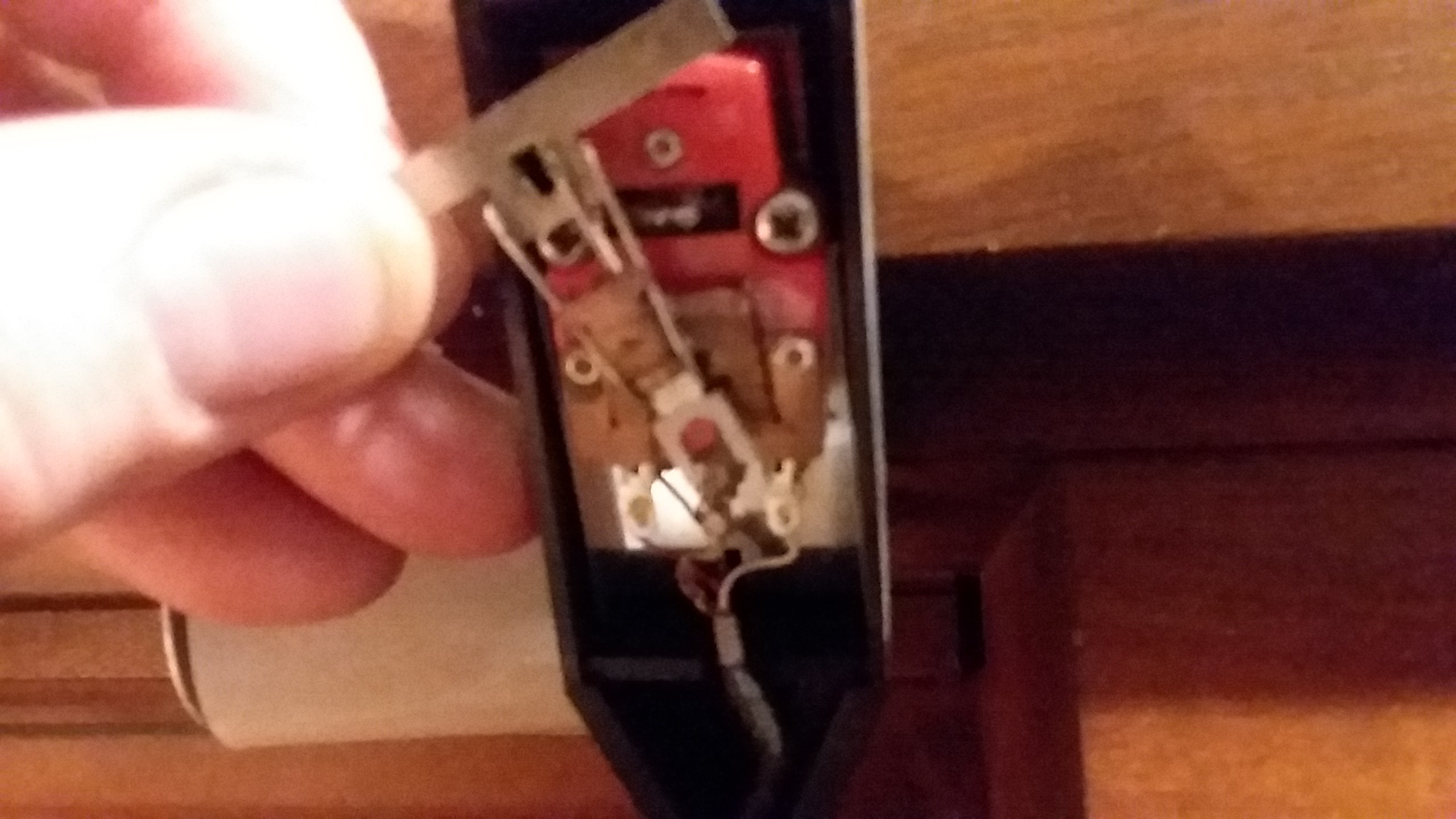

This is a subject in itself but here is my attempt, owning more than a few of these, some functioning.

Here is the "airplane needle" on a 1964 model using an RP-217 RCA changer.

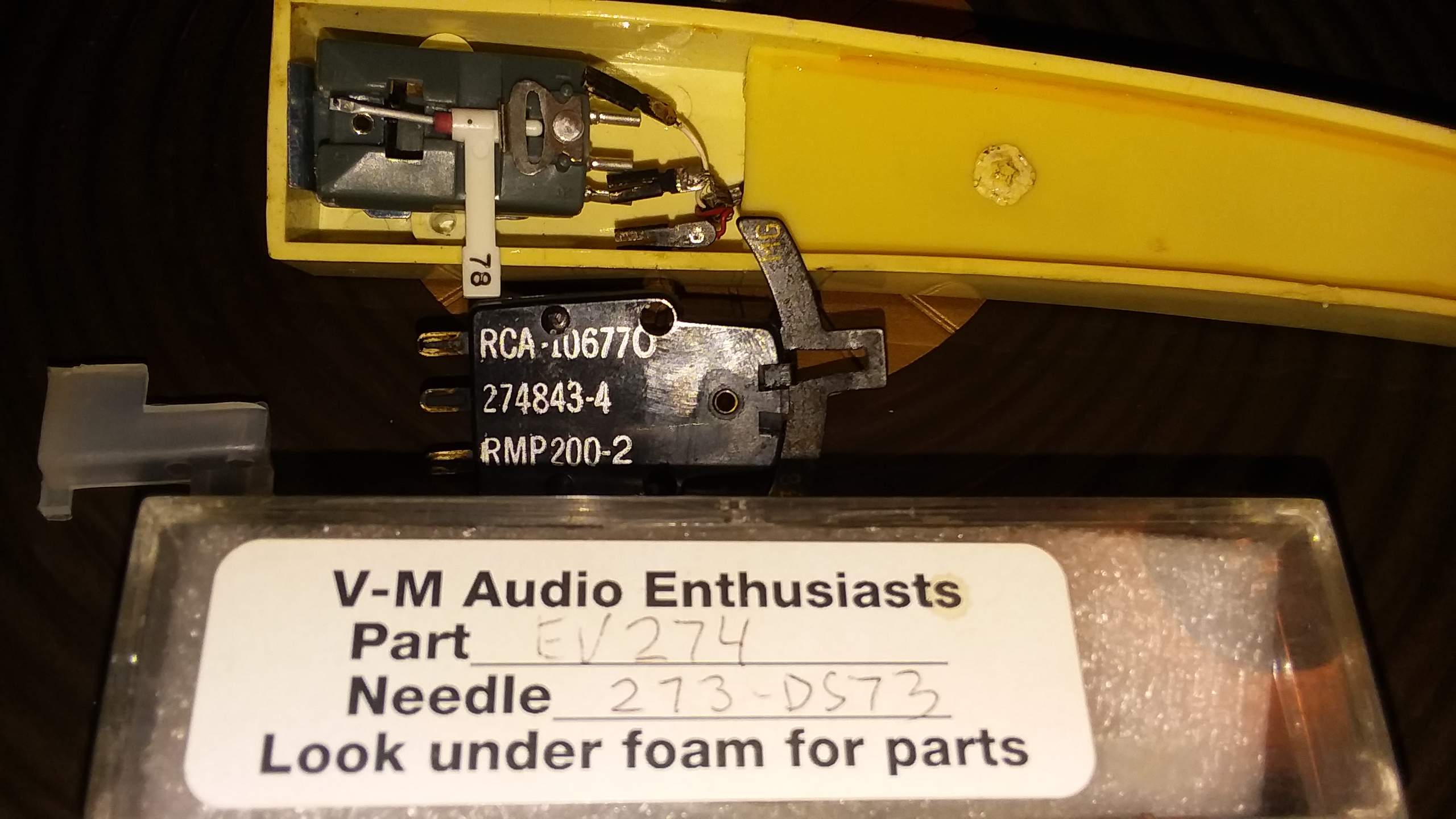

The original carts output close to 0.5 volts, which is close to replacement values of these available cartridges from Varco, E-V and Tetrad

The trick is how to mount the replacement cartridge UP inside the headshell yet maintain proper tracking geometry. For the EV-274 indicated in my picture of tonearm head of a RCA SHC-6, the mounting bracket was modified to sit between the screw bosses that held in the pictured RMP-200.
