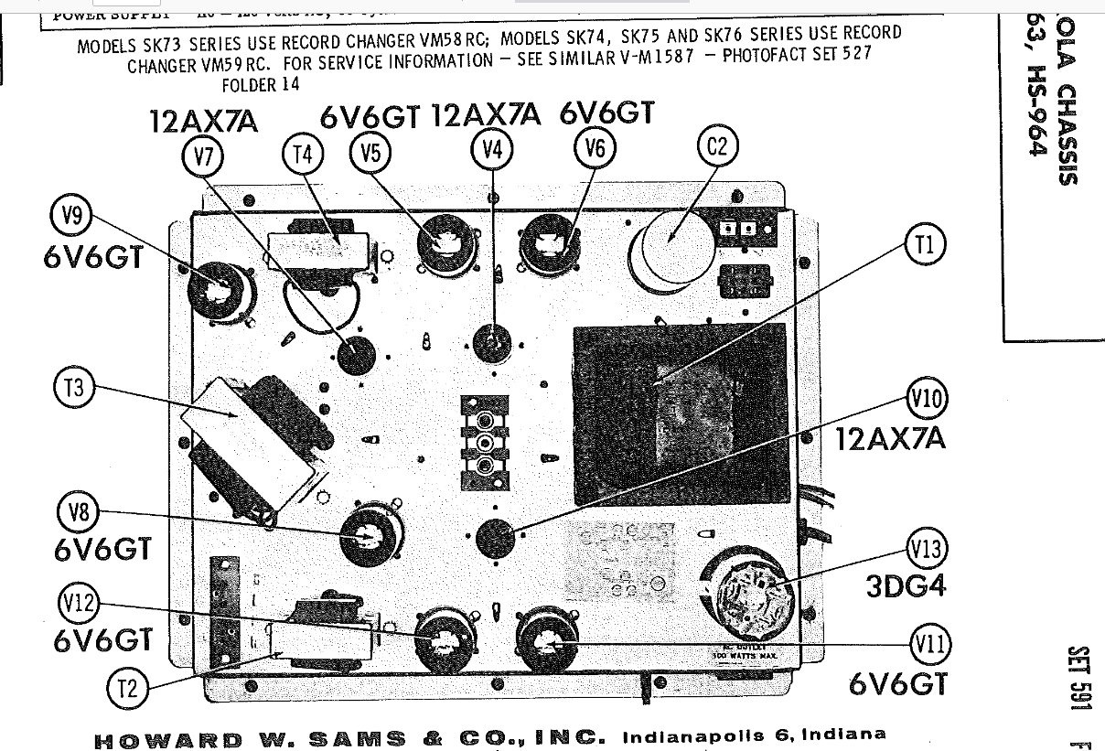

Now for the REAL question, up to now, info ive been able to get says that this model used 6V6 outputs, but mine has ECL82/6BM8 outputs, exactly like a 1964 Lafyette LR-400 on the bench right now. four year differece, Was Motorola that far ahead of the pack, or do i have a franken-ola :roll:

Hi Randy. The 10M60 is correct, October of 1960 is the build date. Do you know your chassis numbers, that will help?
I have a Motorola SK-52, Drexel Declaration cabinet, amp chassis HS-839A, build date September 1960 and it has the 6BM8/6BQ5 amp chassis. Brettsky99 and Motorola Minion (both very knowledgeable with Motorola) will know about the 6V6 vs the 6BM8/6BQ5 chassis and why yours has the chassis it has. I am guessing somewhere in the 1960's era Motorola made a production change.

The Sams 591-9 dates from 1962, with 6V6 tubes in that chassis.
As Bill noted, there may have been a chassis design change,
over several years.
Your chassis numbers will probably give the clue.
That amp looks like it will cook bread !

The Motorola SK74 is sim'lar to an SK52 that I serviced for a customer, and Bill Has :) which is a delightful combination of 6BM8s, pentode-triodes to save on costly 12AX7s and 6BQ5s during a supply chain issue, a unique but very good amplifier. The record changer is most definitely a Voice of Music custom decorated for Motorola. The FM tuner is very selective yet it's not mpx stereo, IIRC.
