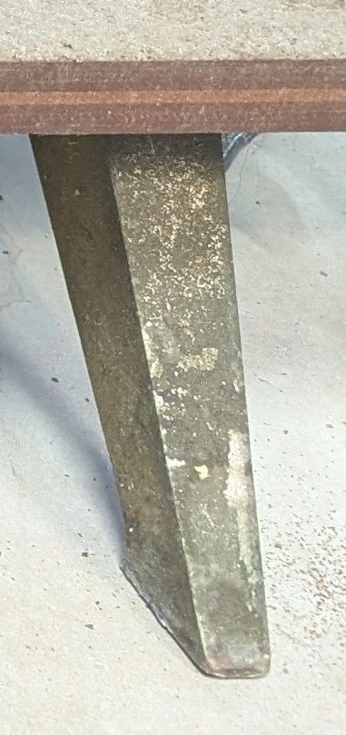

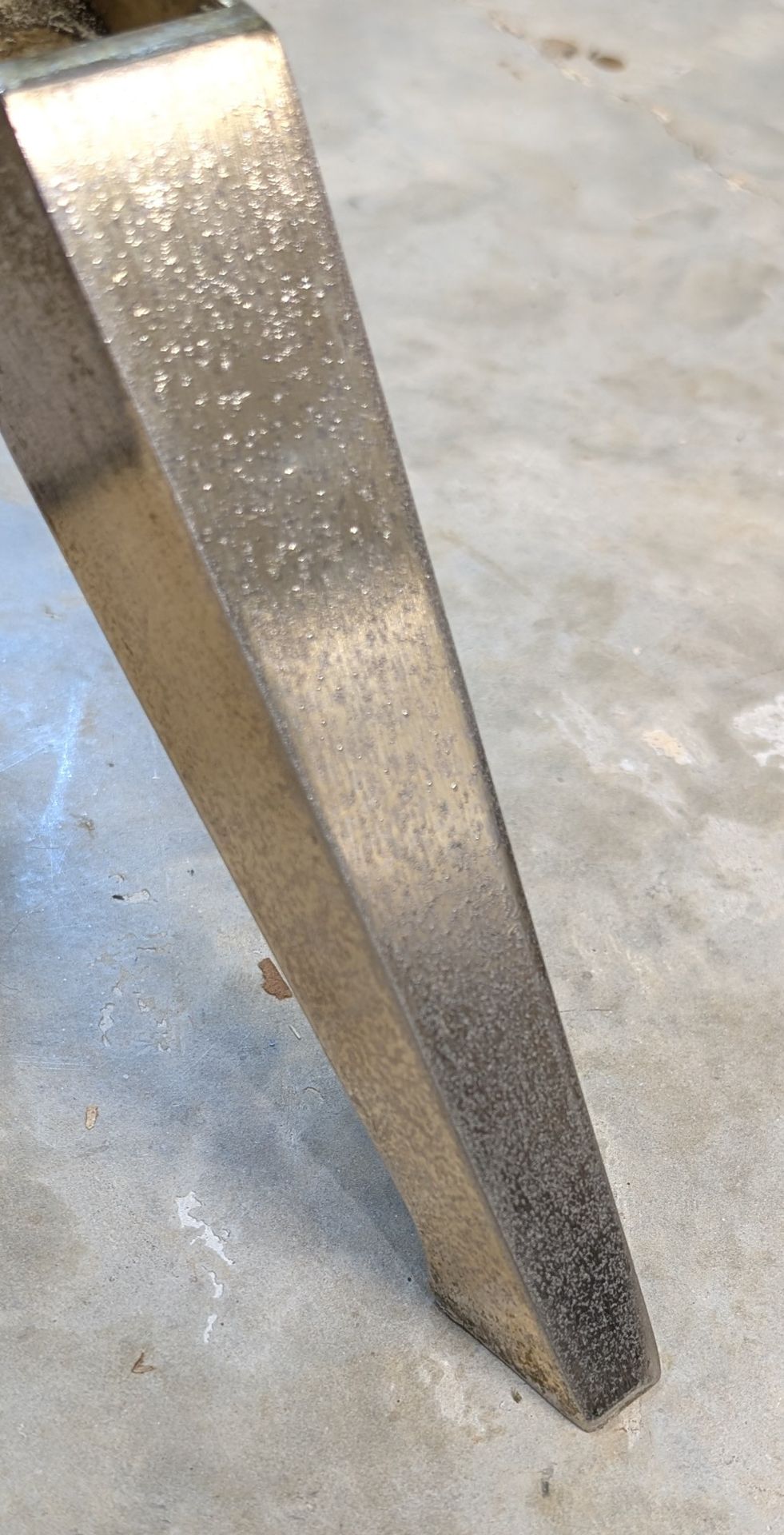

While I'm waiting for the new idler, I've been cleaning the cabinet. At first, I thought the brassy metal legs were solid brass (magnet doesn't stick), but of course they are just pot metal, chrome plated (now pitted and blistered), with a yellowish wash. I'm not going to spend the bucks to have them stripped and replated. But working them over with Brasso made a huge improvement! I think they won't look too bad on the final product, but I wish there was a way to remove the pits and bubbles!
- Posts: 5198
Wow, that is a huge improvement.
