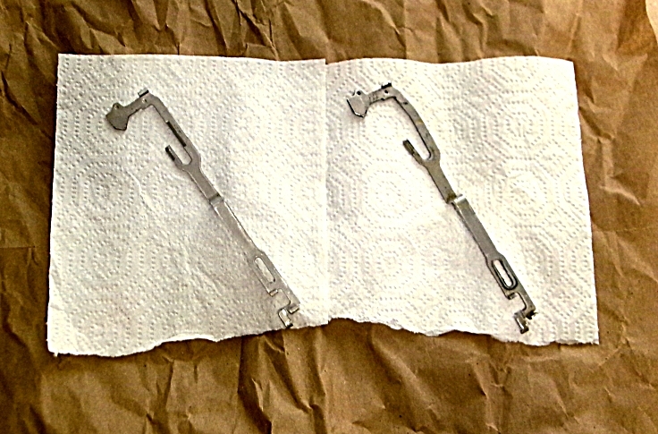

I started on another of my players, a 1957 Phonola 856.
When I removed the V-M 1210 changer, and stood it up
on the work table, I saw the trip link hanging out of
the slide.
Dang. (actually stronger term used)
After I got the slide off, I removed the trip link, and
saw it had been mangled by someone forcing the
mechanism.
(photo of normal vs bent up trip link)
Today, I finished the servicing changer, and put in a spare
trip link.
The V-M 1210 works like a good clock.
No damage to those steel parts anywhere.
V-M 1200s are truly workhorses of their era.

Along those lines, Mr mogul, I've always wondered what happens to the mechanism if the tonearm is locked on its resting post and the changer cycle is started, I've not wanted to try that, of course! Would that do the trip link damage that you found?
