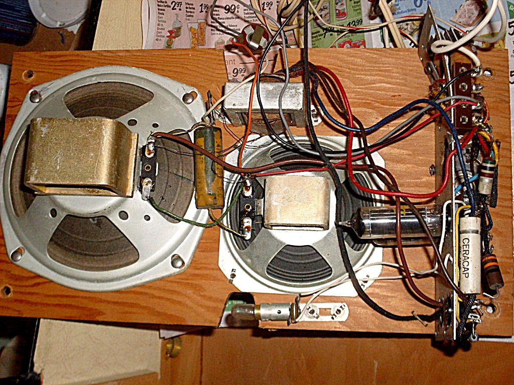

Hello all,
Well, I did it again, dang it !
Found this pristine 1957 Dynavox record player,
that when opened up reveals a spaghetti bowl wiring set-up.
There are no Dynavox 1950's schematics to be had,
so I would like to draw my own for future reference.
This is a 50C5 PP, 12AX7, Selenium rectifier circuit.
Where do I start with this effort ?
Thank you !

That is a good looking unit, Mr. Mogul, very clean, and except for the spaghetti looks to be well built. And, it has a VM changer so it can't be all bad. As far as a schematic goes, I can barely read a Sam's let alone give you advice on how to draw your own. Will this unit be a keeper?

I was going to comment on your photo, observing that they certainly didn't waste any money on steel for that chassis. But then I thought, it's a typically American reaction. We all think that more, heavier, bigger is better. Look at our vehicles, or of more relevance, the ultra-high-end hi-fi components touting their faceplates milled from billet aluminum. But then, if it works well, maybe "less is more." That chassis is hidden away from fingers. It might also ventilate better with the minimal steel. I look forward to a full performance report.
