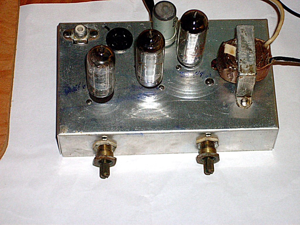

Hello all,
These brass fittings are used commonly in vintage hi-fi
amplifiers to secure the small amplifiers to their
cabinets.
They fit over the threaded shafts of potentiometers,
such as Volume and Tone control pots.
What would these named, and where would they
be available for purchase ?

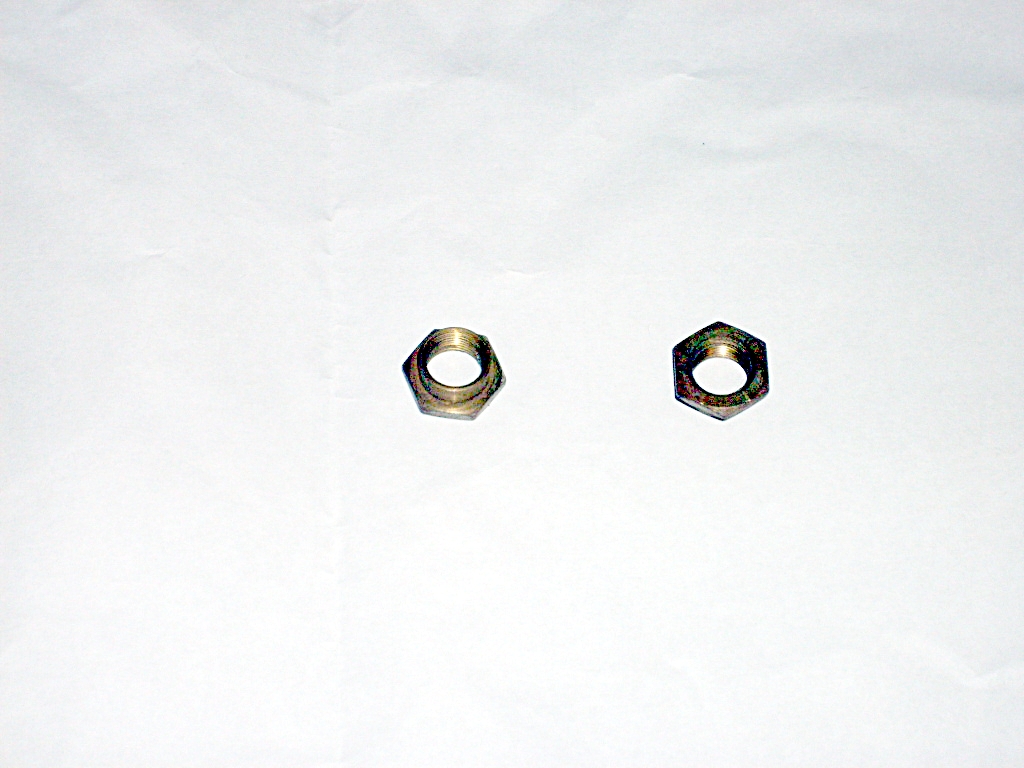

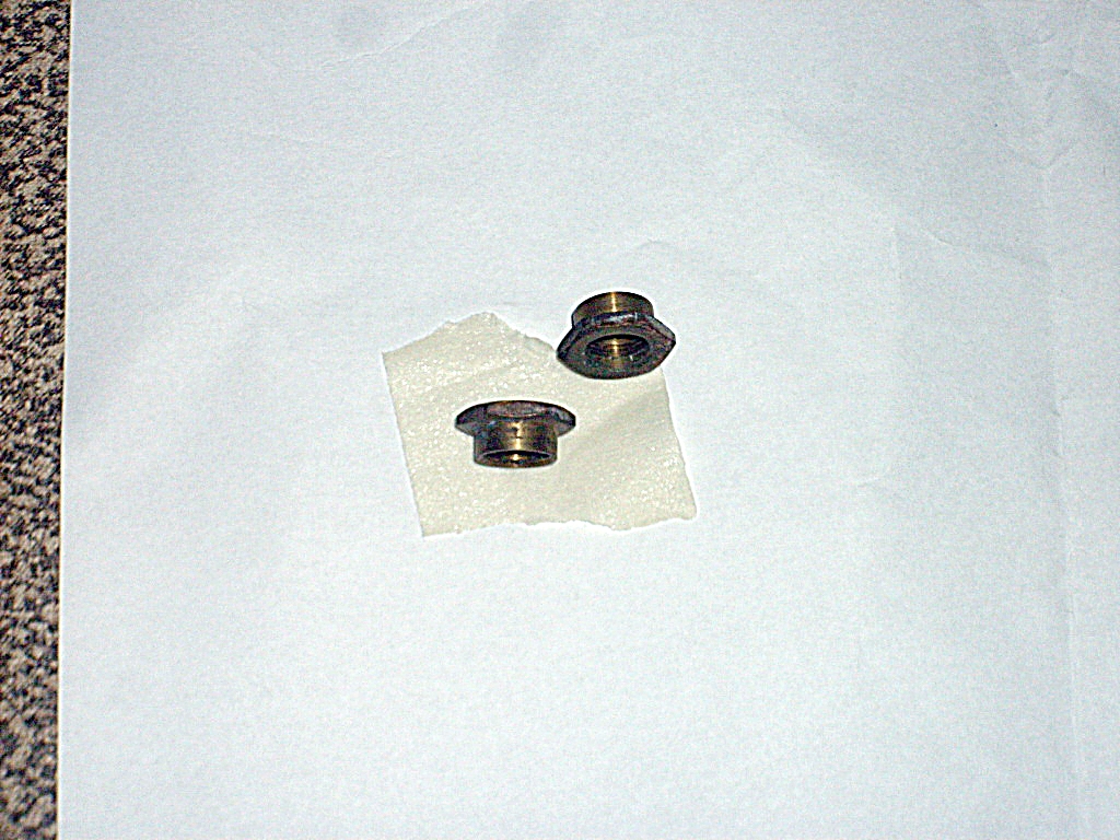

Dimensions (as close as I could estimate with a ruler) :
Inner threaded diameter: 5/16 inch.
Depth: 1/4 inch
Hexagon diameter: 1/2 inch.
cabinets.
Depth: 1/4 inch

That is some kind of a collared nut. You might consider making one using a plastic sleeve and a nut from a ceiling fan. Our local ACE hardware has a huge parts cabinet with every kind of fastener known to man. I would visit a good hardware store with the collared nut, then find a plastic sleeve and a nut that will get you in business. I wouldn't have any idea where one could buy an original nut like that.

The are the "electrical variant". I believe they have 32 thread pitch, IIRC. All I know is that, in my experience, the nuts for ceiling fan switches have worked on radio control shafts, volume, tone and that. May not be the case in all situations, so your results may vary.

I had already found the original source of the product that Doug posted,
and the collar nuts' dimensions are much larger and cannot be used.
