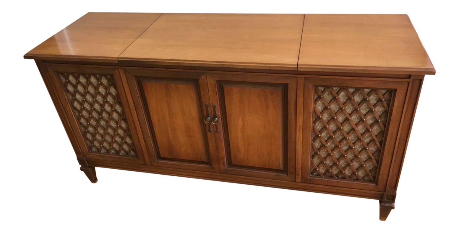

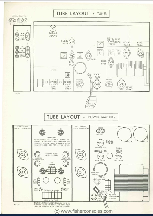

These two Fishers have one of the most interesting views from the rear. One obvious harbinger of the future you see on almost all the later consoles is enclosed (boxed) speakers using particleboard (not MDF) where plywood was normally used. The tube map is located below. There is no cabinet back cover, you can see it all.
The contemporary Warwick looks like a Futura and Ambassador, while the Italian provincial is walnut with a darker finish.
