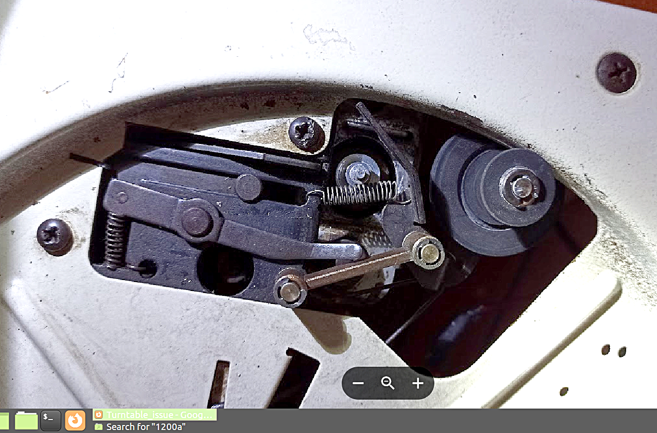

Ok, just removed the plate.
Placed a photo and video here:
https://drive.google.com/drive/folders/ ... sp=sharing
Shouldn't the idler wheel be in contact with the record speed selector/shaft?
The motor mounts were not replaced, as far as i know.
Anyway, I pushed the idler wheel a little so that now, when I turn the switch to the ON position, it comes to contact with the speed selector and turns normally.
Uploaded a video and photo of that one too.
It seems that the problem occurs if the OFF-ON-REJ button is turned counter-clockwise, i.e. before the OFF position.
Now I must manage to put the plate back in place to test it :-)

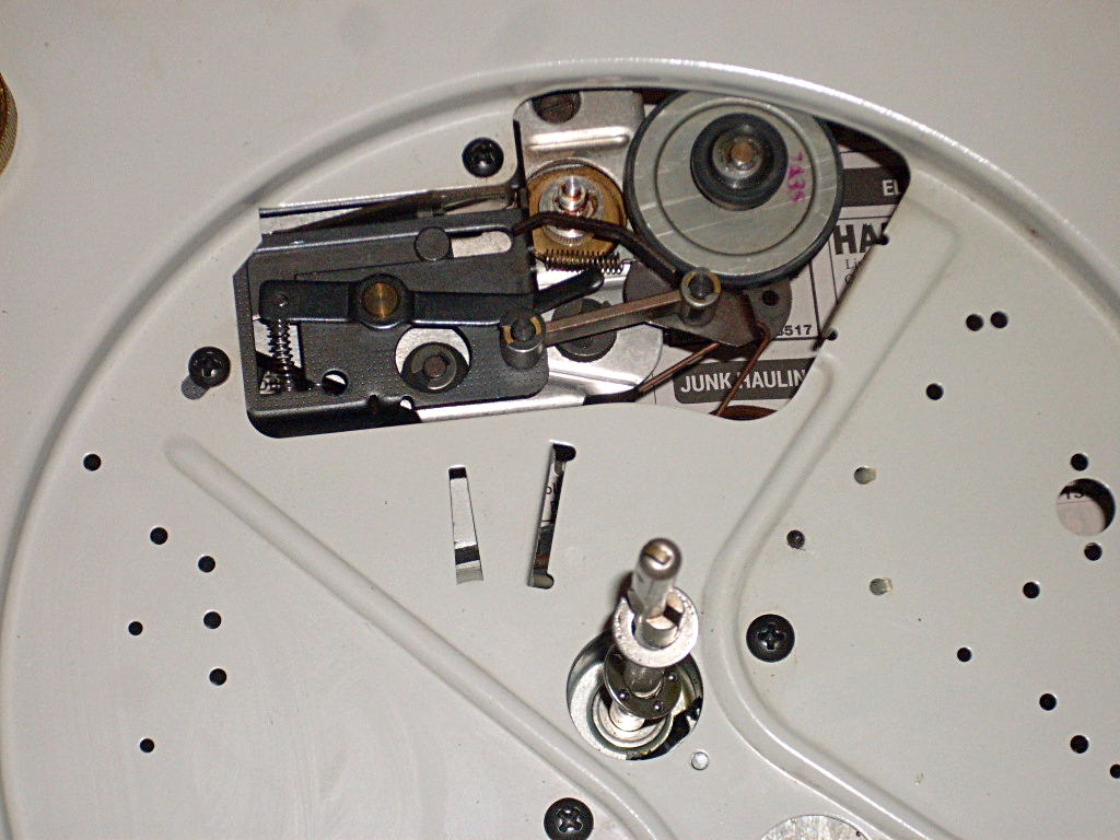

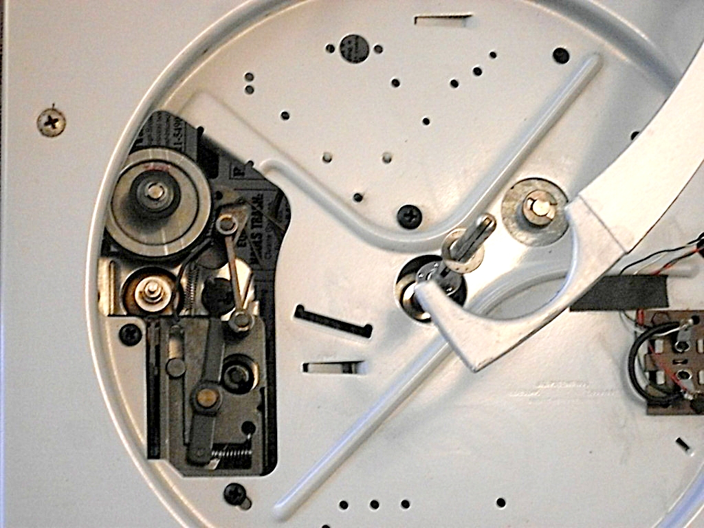

Posts: 1342
Re: VM 570 turntable stopped working...
Post: # 23600Post Hi-Fi-Mogul »
Andreas,
In your photo of the idler wheel motor plate assembly (3rd down):
The idler wheel retraction spring is not mounted on the motor
plate assembly correctly.
The left side of the spring in your photo is what I refer to.
There is a milled hole in the assembly edge near where
the spring currently is mounted.
In addition, the idler arm assembly is located incorrectly.
The "blade" of the assembly should be to the right side
of the motor spindle.
The first 2 of my photos show the correct orientation of the
idler arm assembly and the spring.
Posts: 5318
Post: # 23604Post William »
Andreas. What Mr. Mogul stated is correct and his photos are spot on so that should help you solve your problem. And, as electra225 mentioned, you do have the system that pulls the idler away from everything when the changer is in the off position. I would also suggest that you get some motor mounts from Gary and change those out if they have not been already changed.
To answer you last question, you will need some needle nose pliers or something that will pinch. At the top of the spindle there is a chrome thing that pulls up, and that needs to be extended before the platter will fall down where it belongs. What I do, is set the platter in place, then push the chrome thing up from the bottom with my thumb and grab it with the needle nose pliers continuing to pull up on it. Once you have done that, the platter will fall and then you can work it on down. Make sure one the platter is set in place that you carefully rotate the platter to make sure the idler is under the platter where it belongs. If you have everything in place your changer should work as it should.

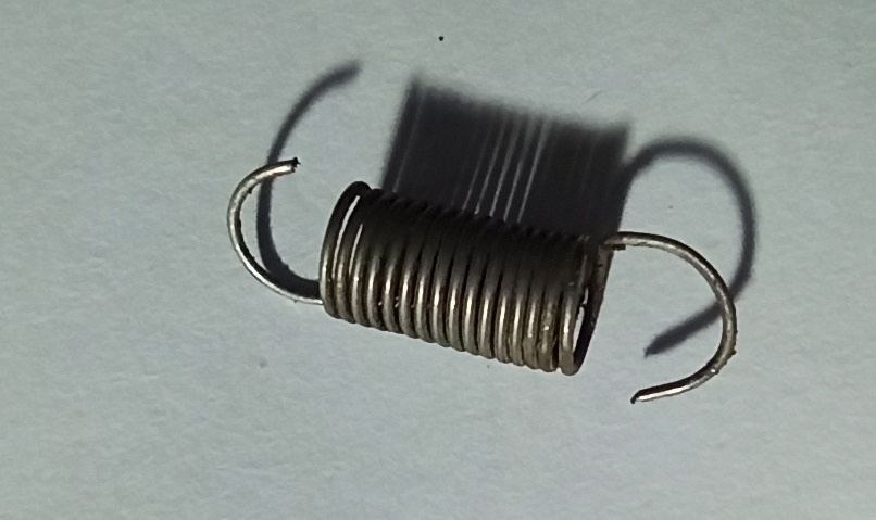

Post: # 23610Post anpap »
Thanks guys! Really useful information!
Wouldn't have noticed that...
I managed to fix the spring location and the blade location (see photo), but the spring came off after a couple of tests.
Maybe the spring needs to be replaced?
Will try again, anyway, and see.
- Andreas
spring location fixed
Posts: 1342
Post: # 23611Post Hi-Fi-Mogul »
anpap wrote: Sat Nov 16, 2024 4:44 pm I managed to fix the spring location and the blade location (see photo), but the spring came off after a couple of tests.
Andreas
The spring looks fine.
Bend the open ends of the spring closer, so it will
not slip off the mount holes.
The idler wheel is in the correct position
per the photo you posted.
Please turn the On/Off/Reject knob to Off position, to
verify the idler is pulled away from its position in
your photo.
Post: # 23634Post anpap »
Managed to attach the spring more securely now.
(A pair of forceps really helped. )
Also managed to put back the plate and it works again now!
