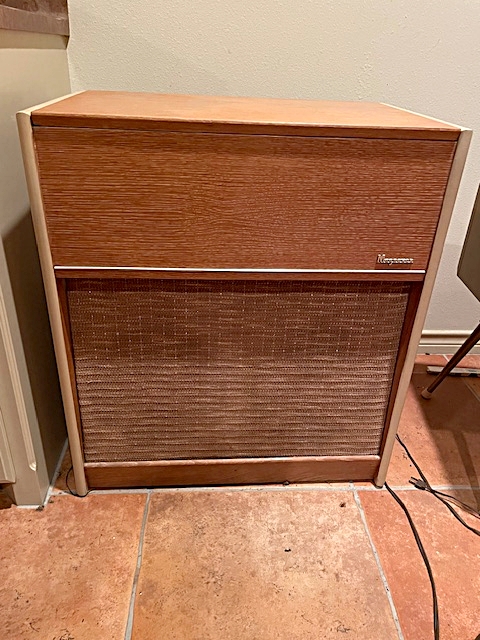

I may be able to pick up this nice blonde for $50 or
less.
If anyone knows, please provide the model and what the amp/receiver is.
It appears to be a mid 1950's model, looking at the
Collaro changer model.
Thanks !
What is this Model Maggie ?
- Magnavox Model-1.jpg (236.79 KiB) Viewed 17326 times
- Magnavox Model.jpg (189 KiB) Viewed 17326 times

Re: What is this Model Maggie ?
Looks like my '56 Magnasonic, but blonde and with the tuner option. AMP-128 A or B. It's a big 4x6V6, parallel P-P amp with a large OPT, and 2-12 speakers with 2-4" cone tweeters mounted coaxially.

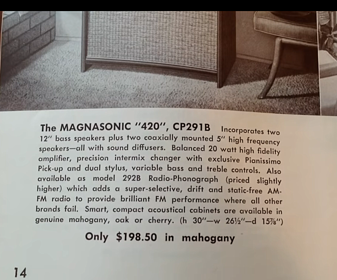

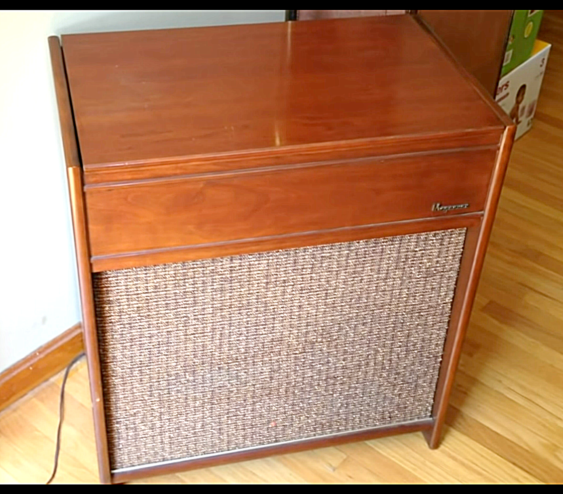

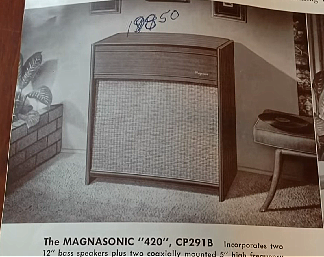

So I found a video of a 1956 Magnasonic 420 sans the receiver.
And I found the page in the 1956 catalog.
Screen photos from video.
It looks to be a 420 with the optional AM/FM receiver that
Chris mentioned.
With 4 PP 6V6 outputs, it should rock the floorboards !
Chris mentioned.
