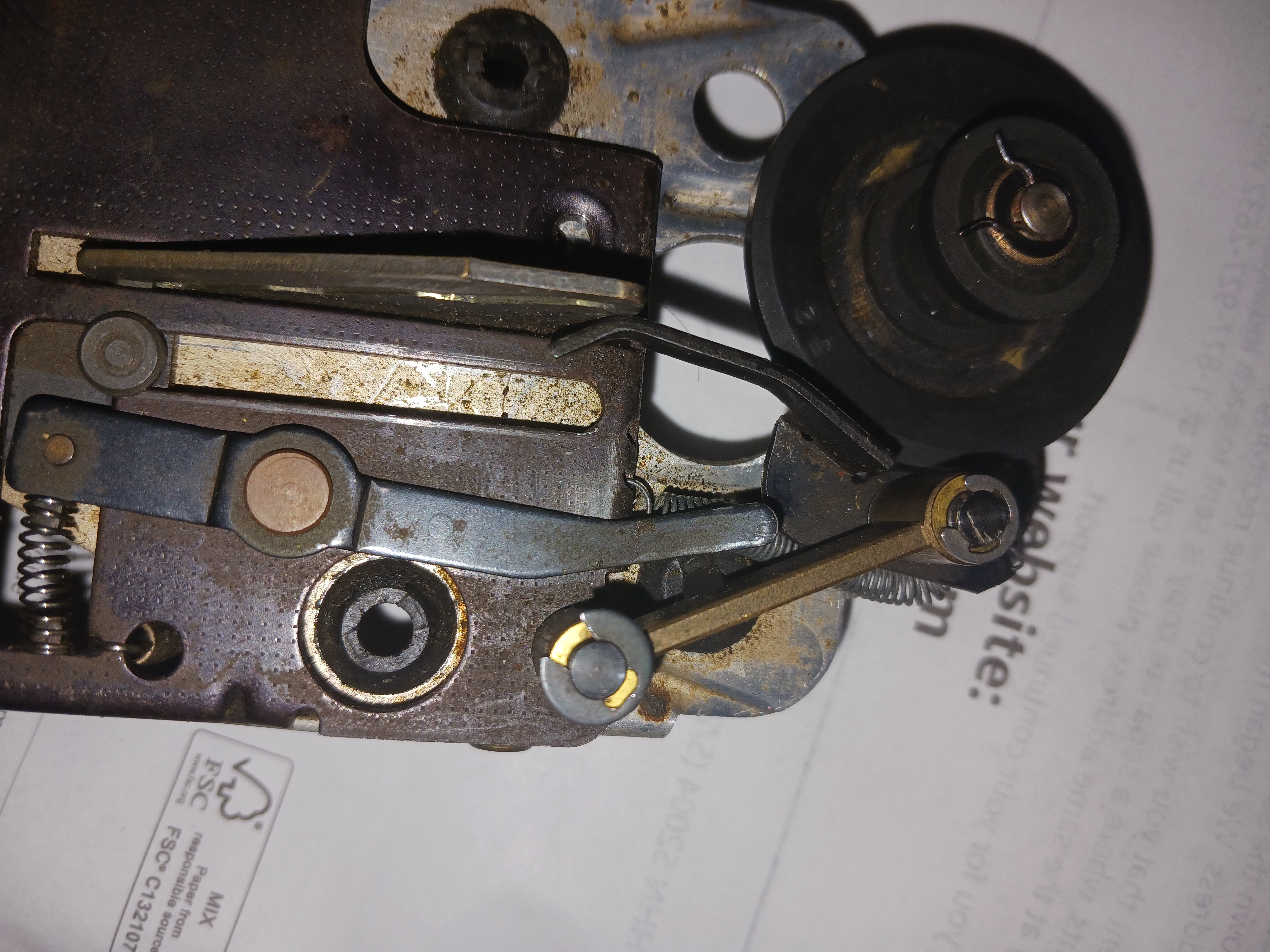

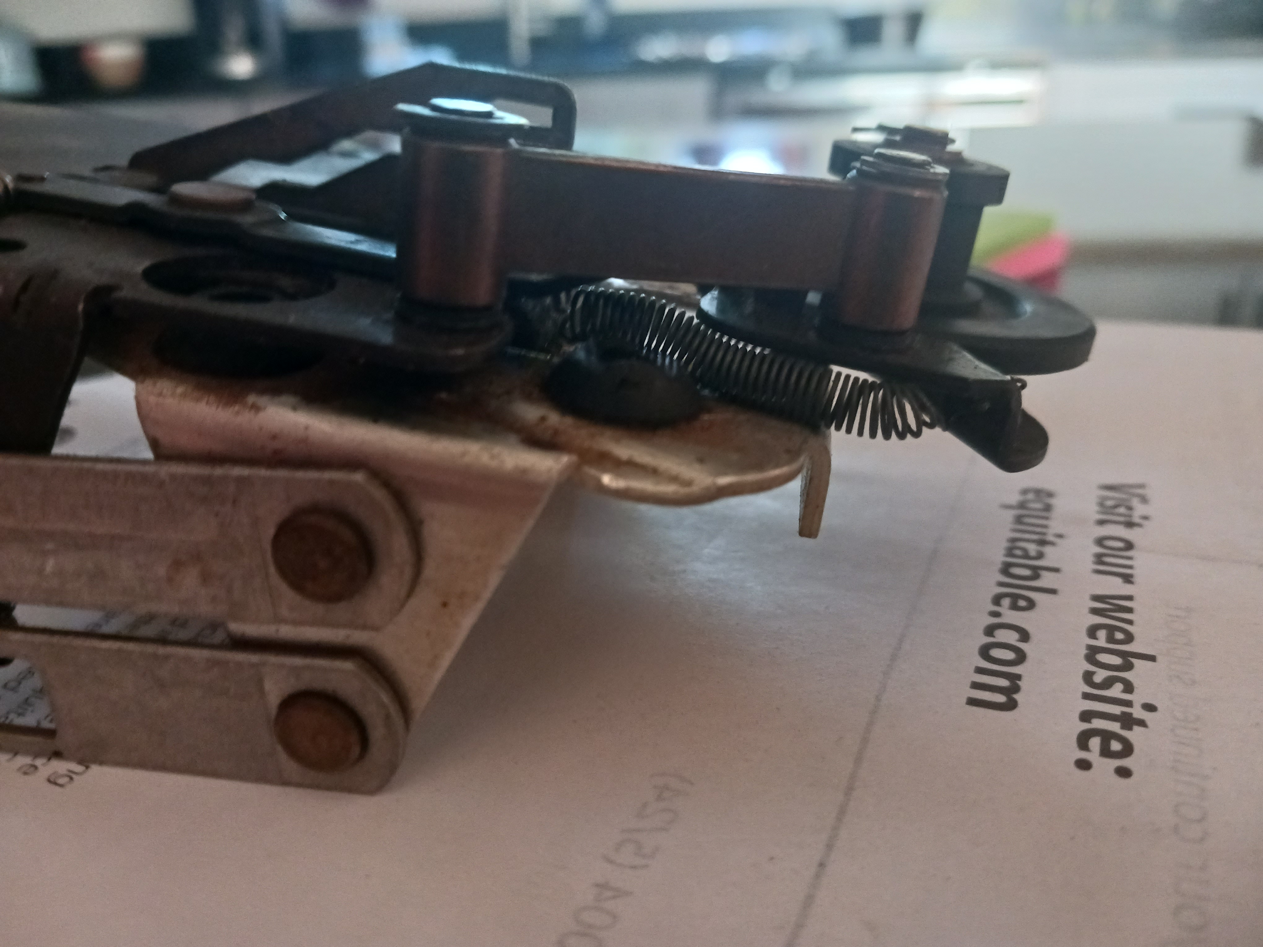

Post: # 22208Post hermitcrab »
this is out of the Motorola ... is this spring in the correct position?, seems to be interfering with everything while in the 78 position... it seems to be too thick for where it goes , but this is what was in there...the Sam's doesn't tell you squat on where it attaches , just shows the spring in the blown up picture

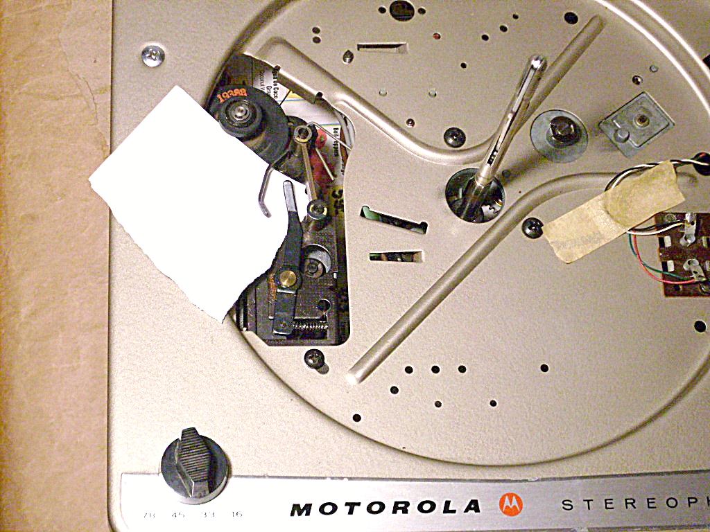

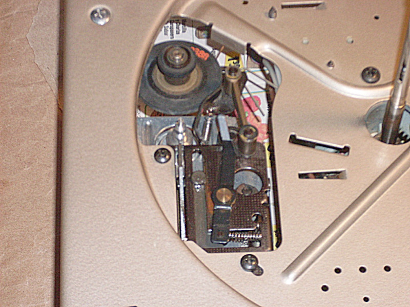

1. One thing that may be incorrect is the orientation
of the idler link.
Some of those idler links' mounting projections are of
different heights in some V-M changers.
2. Is the idler spring located in the right place ?
I just restored a V-M 1241 out of a large portable
Motorola.

Post: # 22212Post hermitcrab »
That's the problem, IDK if the spring is in the correct place or not , the Sam's does not show where it attaches, there are 2 different holes on the idler wheel assembly , I still think the spring is too large of a diameter where it is located , if it is the correct spring , someone has stretched the hook out of shape at one end

Post: # 22215Post William »
Yes, Elton, that spring is WAY too large and not the correct one. There are different springs, it is called the "idler spring," and Gary should have the correct one for you, just provide him with the correct changer number.

Post: # 22217Post Hi-Fi-Mogul »
William wrote: ↑Wed Jul 17, 2024 12:13 pm Yes, Elton, that spring is WAY too large and not the correct one. There are different springs, it is called the "idler spring," and Gary should have the correct one for you, just provide him with the correct changer number. Bill
Bill, good catch. From those large photos, I could not tell
the spring's length size.
It did look way too fat, though.
