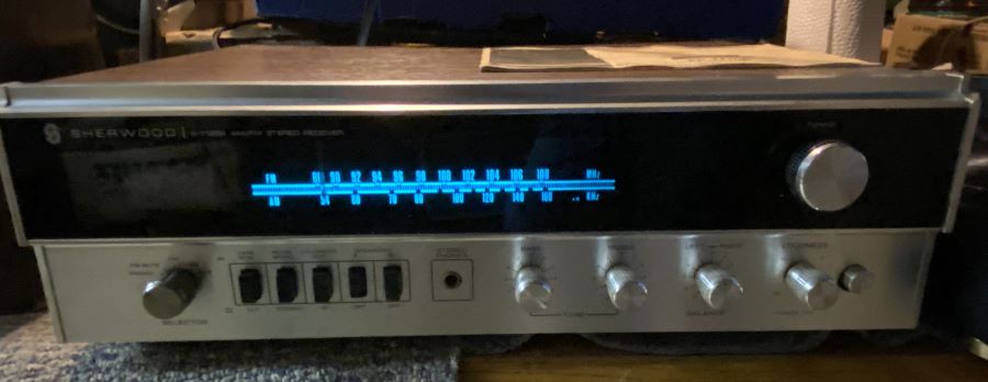

Post: # 21207Post Motorola minion »
I have an affinity for Sherwood that was started by the model S-2200 tuner introduced just before stereo FM. My grandfather bought one with his Scott 222 amp in 1961, was so impressed he got a second one to play over the PA system(S-C Signet 70 using 6550 pp) in his machine shop. The 70 watt output was pared down to about 5 watts each to the dozen or so Utah speakers via the 70 volt speaker wiring.
This receiver was of the last Sherwood components made in Chicago. Once made in Japan, Sherwood was decent quality like the newly-offshore-produced Harmon Kardon 330. Still, you cannot beat a USA-made solid state receiver like this or HH Scott, etc. The serviceability is excellent as there are no oddball parts. Just Bendix and other premium transistors which rarely fail.
The s7800 was introduced as an "all-silicon" solid state receiver in 1966 with sucessive improvements. I bought this late production model and its little brother, the s7600 at a swap meet 10 years ago from Ron Ramirez, author of the Philco radio book. Both sets needed recapping, especially the 1mf to 100mf ranges. Power supply and speaker coupling caps 500 mf to 2000 mf tested good ESR. I use these alternately in my detached garage until one of the preamp transistors in s7600 crapped out and one of two "microcircuits" (early 6-lead with four transistors for IF and detector stages) inside in the s7800 went. I was able to get both parts and restore them to original operation.
Garage? why there?
1. Sherwood tuners with FET (field effect transistor) front end are able to select much weaker adjacent channels to strong stations. Lousy reception locations need a receiver like this, an absolute must in this area! Translators have been popping up all over FM band, making this problem worse. I have a Winegard 10-element FM antenna on the garage roof with a rotor so I can aim at desired signals and de-select the too-strong signals my location is saturated with.
2. The 70 watts per channel is into 4 ohms. The Pyle 12" units I have are not that low but at 1/3 volume, the headroom is incredible and the Magnavox horns are intense even through my 2nd order crossover. No way can I play this in the house when anyone is home.
3. Solid state units, if left on inadvertently, will probably be ok. I often have it on while doing yard work, as Im always in & out of garage but still want to hear it. I play records on a 59 Magnavox stereO-rama that resides there also but it shuts off automatically
First picture is a circa 1979 Sherwood s7125b, sold a few years ago. Made in Taiwan IIRC
