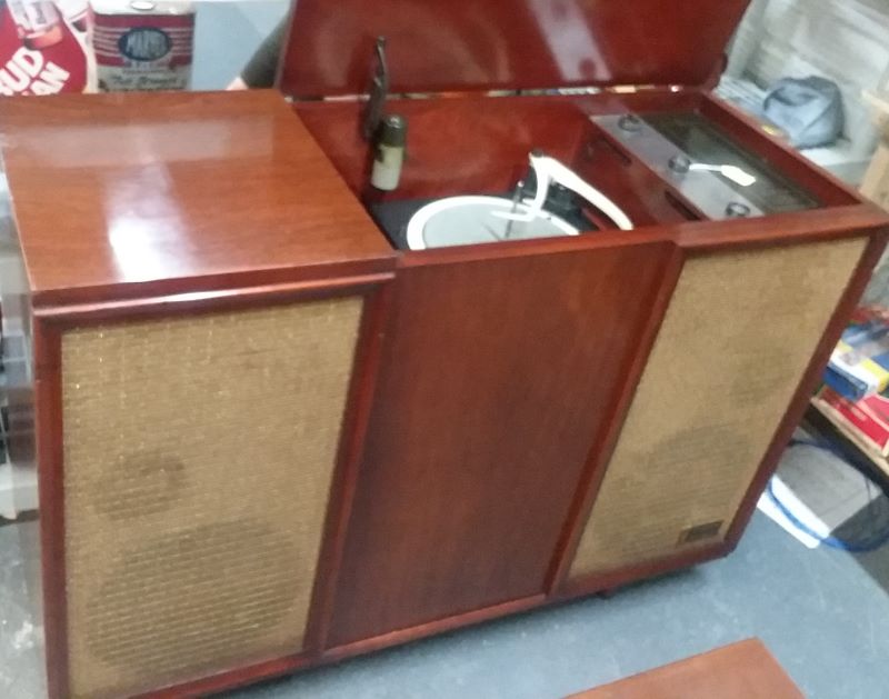

Z forum needed some new material. My last visit to the Delaware Valley Historic Radio Club's Kutztown antique radio expo netted me the entire insides of a 1963 MK2607 and this handsome (record player only) console from 1960.

The mid-level models of which the SFD2505 is one, uses a single ended 6BQ5 stereo amplifier that is rated for 10 watts. Chassis 5B29 for the phono-only and 3K32 for models with tuner, B+ was 330 volts. The 12" LF speakers with 6.8 oz. alnico magnet p/n 49CZ852.

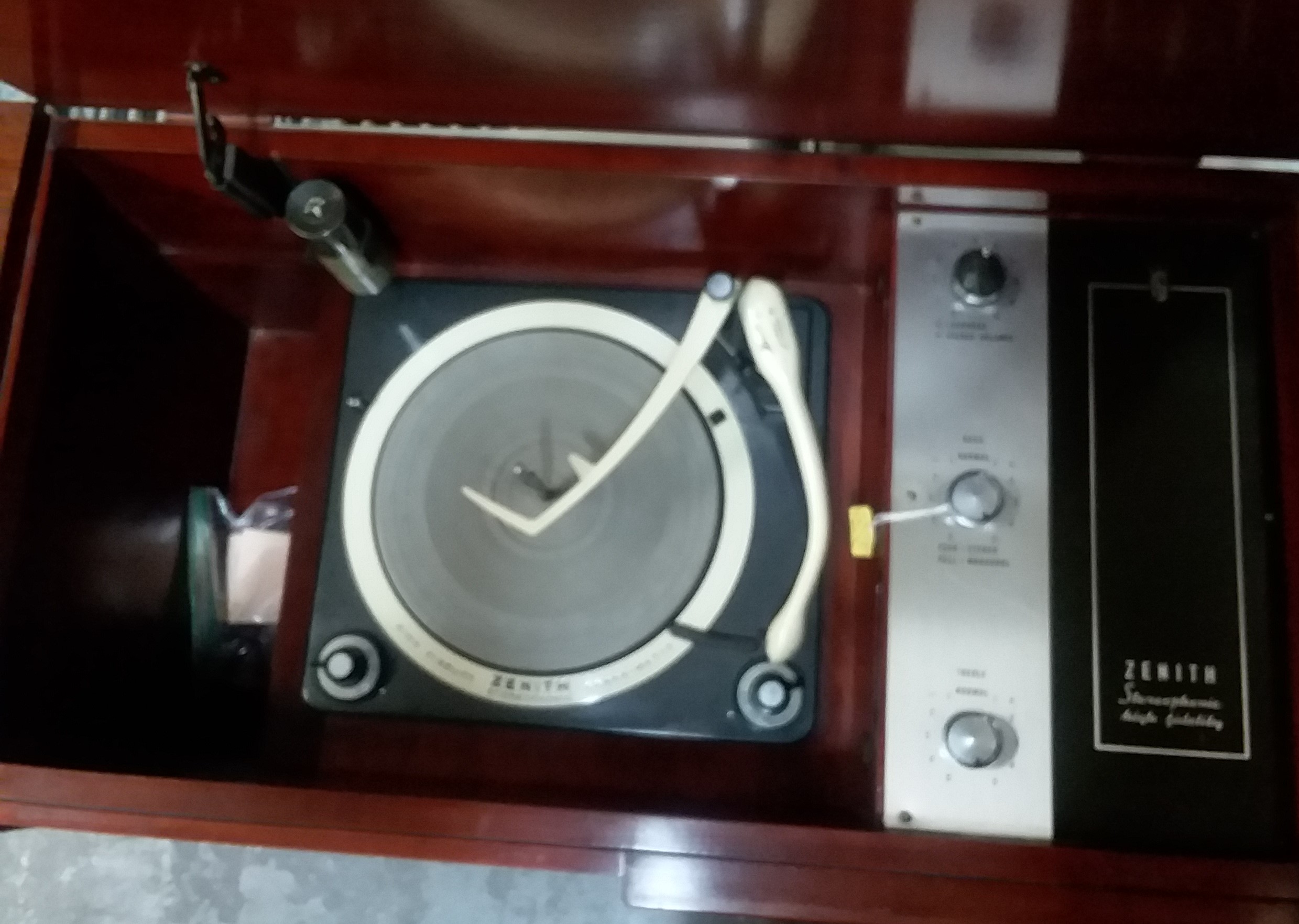

Record changers were pretty simple, cobra-matic tonearm and platter trim on a VM built 1200 series. The optional Zenith built belt drive changer was a desirable upgrade.

A few years ago, I got one identical to this one in limed oak (blond) cabinet. It was $15 at GW, its original record changer replaced with a seized up BSR. I recapped the amp, added an aux input cord, record compartment lamp and a generic VM changer that just looked right in there. It sold quickly on CL but before I sold it, I showed it off in a big way.
