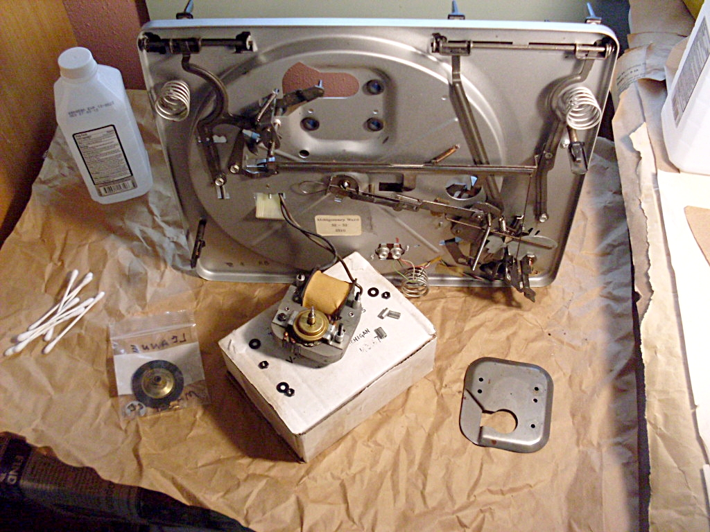

Two nice young sisters brought their Grandma's Ward's
Airline console by for removal and service of the record changer.
Maestro is reported to have been a cheaper changer used in
lower end hi-fi's in the 60s.
But, this Airline radio/amp chassis is very well made.
I don't think the console was an inexpensive item.
It uses single 6BQ5 output tubes.
Two way woofer/tweeter with a crossover.
The cabinet is a lot of solid wood, in colonial style.
The Maestro has characteristics of both BSR and Garrard
mid-1960s units, but is U.S. made.
The Maestro uses a manual record size selector, with
all other functions automatic.
The Ronette 105 stereo cart has good output on each
channel, and the idler wheel still pulls through cycle.
I ordered a new idler from V of Music, though.
I did not have to do much dis-assembly for cleaning, with
exception of the motor.
The hardest task was removing the grease-locked record platter.
(another characteristic of BSR/Garrards, ha ha !)
I applied heat to the spindle for that.

- Posts: 1345
Re: 1965 Maestro Model 52
Question:
Is the metal plate the motor is attached to for
reducing any inductance or field created ?
It may just be engineered that way, but I've not
seen anything similar.
- Posts: 8922
It looks to me like they only use three bolts to mount the motor. Maybe that plate is there to stabilize the motor?
- Posts: 5351
Do you have a photo of the topside of the changer, platter removed?
