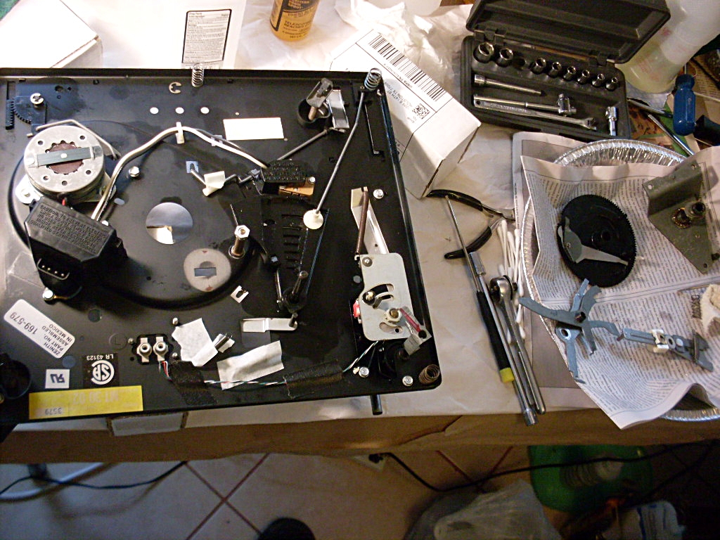

While I've been waiting on parts to complete the Zenith
Cobra Stroboscope, I took on this Zenith-branded
belt-drive BIC.
The stereo AM/FM/8-track/Phono unit it came out of
is a very nice product made in Korea.
The OEM tonearm cartridge is a Shure magnetic of all things.
Why Zenith put in such a cheapo changer....
BIC seems to have made some good changers,
apart from this one.
I could not find any info on this low-end model, which
differs in several ways from the better models.
Thank goodness Jordan Pier made some videos re: BIC 940,
which is similar enough to do the service on this one.
I had to make a counter-weight out of washers glued together,
as original is gone.
The spindle is held in place by a clip, which also is gone.
I think I have a BSR clip that's going to work.
Along with the Cobra parts, I have a belt and new stylus for
this BIC coming.
Possibly both will be complete this wknd !

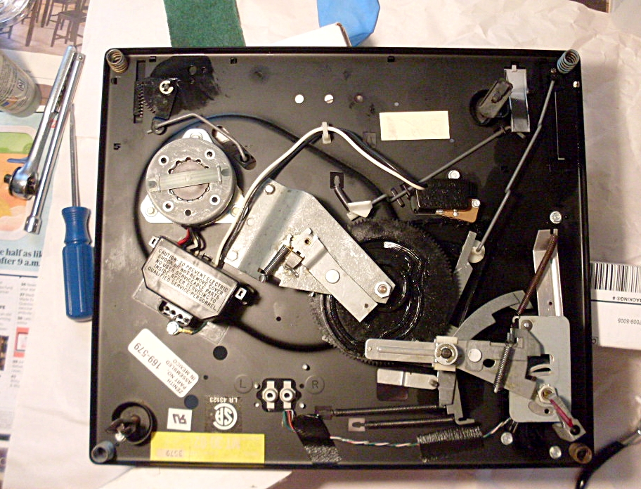

After all that effort, having all previous problems
identified, and the belt and stylus installed, one last insult.
I pressed the button that should have started the cycle,
and nuttin'.
I turned the platter by hand, and it rotated and went into
cycle properly.
I tried to repeat a record play, and no motor turning.
After some swearing, I checked the new belt (OK), then
I wondered if the switch was oxidized.
I also wondered if the motor could be worn out, since
it has a magnet in it.
The switch is riveted together, and I then decided that
Plan B was to be followed.
I called the owner and said I was going to replace the
BIC with a BSR that I had already completed.
As I noted previously, the BSR changer base has the
exact same dimensions and spring locations as the BIC.
The circuit is such that the record player does not have
to be wired in for the other functions to work.
Along with those funky Garrards, BICs will be added to
the list of "no go" repair items.

I got the BSR installed and checked out the Zenith stereo.
The back panel of the Zenith multiplex stereo had a
removable plug that I ran the BSR power cord through.
I put a strain relief on the AC cord.
The young man came by today and was wowed by
his "new" system.
It did sound nice. I had some small Realistic Minimus
speakers hooked up for full vintage sound.
After all the cussin', it's great to see someone so happy
with their family's record player back to snuff.
