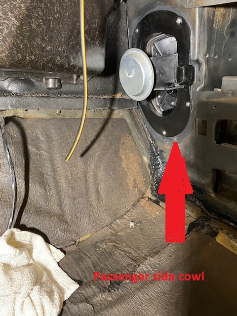

I wish the A/C in the Chevelle worked. The seal in the compressor (among other things) went bad many years ago. I'm trying to get everything else going (electrical, vacuum lines etc), so maybe some day when the "budget" allows, I can get it working. Many folks swear by the cooling power of the A6 compressor.
And what a timely topic. I unfortunately discovered this weekend that the actuator pod on this item is no good. It won't hold vacuum when I tested it with my MityVac. I found some used parts on eBay so now that the wallet is lighter, I hope they work.
I know what this is (the device in question with it's actuator pod). So for fun, do you guys know what the purpose of said item is and how it work?

My guess, it's the actuator that allows recirculation of the interior air when controls are placed on "MAX", or it allows fresh air when in normal mode. I'm not sure what it says on the HVAC controls on the dash on your Chevelle but I'm guessing "MAX"?

Buick had separate acuators on the vents, so they would operate on vacuum via the climate control system. I would guess that one would be in the recirculation system.

This door works together with a flapper door up in the actual cowl of the car. When you place the A/C in "MAX" position, vacuum is applied to the orange tracer vacuum lines (there is a factory "T" to both control pods). The door in the cowl chokes off hot/humid outside air being drawn in by the blower motor. The blower motor now needs a new source to draw air from....thus this side cowl door opens up. This side door draws in the air that has already been cooled in the interior back into the blower motor to be redistributed back thru the A/C box and back into the car. By "re-using" the inside air, you are getting the "maximum" cold from the A/C system.
Now, the one catch is, and the owner's manual warns you, that if you leave the A/C control in the "MAX" position for too long, the air in the car will get "stale" as no new fresh air is being pulled in from outside.
Now another question for you guys.....
I'm using my MityVac to test the various vacuum pods and vacuum lines in the car since the dash is out. How much vacuum (Hg) should I be applying to the various components? I don't want to damage something and I don't know what kind of pull the engine would provide at idle.
Stock small block hydraulic lifter V8. Vacuum hose from the manifold is connected to a "soup can" (vacuum resovoir) underhood, from here it runs into the interior into the HVAC controls where it is then sent out to the various pods depending on what setting I select on the the 'ole slider control....

Pull a vacuum hose from the carb area as if you were setting mixture and see what the engine vacuum is then use that number. I'd say 16 to 18 in hg is safe.
Or... if your ac dampers run off the vacuum tank, hook up the gauge to that and see what the tank steadily holds on the outlet side. You'll have to run the car again for it to refill and stabilize.
